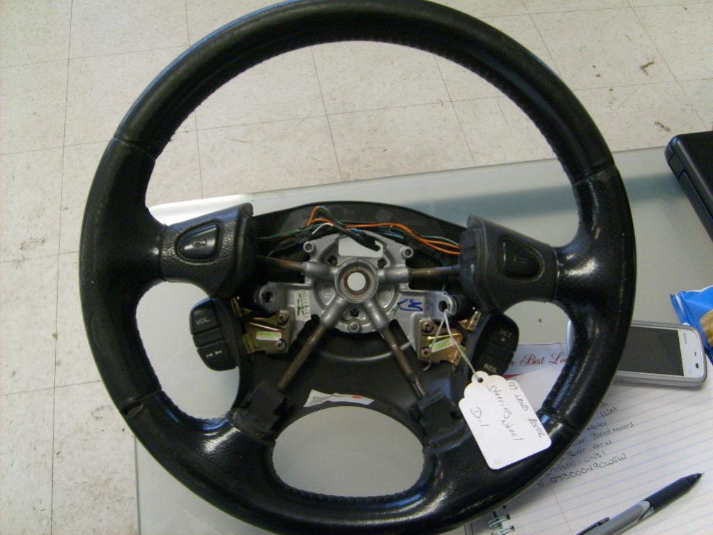

Would a 98 D1 LE have the wiring to make use of a 97 D1 steering wheel with radio controls on the wheel?

As Rosana Rosanadana said, never mind. I just realized the wheel on eBay is much different than my 98's wheel and would need a smaller air bag to go with it as well. Too bad, radio controls on the wheel would be handy.
Attached Thumbnails 97 D1 steering wheel with radio controls fit a 98 LE?-1997-steering-wheel-ebay.jpg

Assuming that the system is similar to the Rover cars of the era (and a lot of the electrical system is similar) then you can add the controls to your existing wheel (2 screws) and connect it to the rest of the wiring through fitting the appropriate clockspring/rotary coupler. On the Rover cars you would then need to run two wires from the back of the rotary coupler to the ISO connector on the radio.
