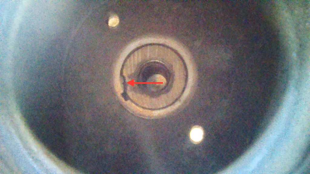

Well, here comes the cautious part. After doing the oil/filter/pressure switch change, I worked on something else that's been bothering me lately which goes back to my first post here.
After that post regarding the crankshaft pulley that came loose, I got the pulley back into position with the installer kit that I rented from AutoZone, but the kit wasn't the best fit for the recessed pulley on the Rover and getting it back in was a huge PITA--a big crescent wrench on the shaft nut which was recessed about 3" into the pulley. So a few weeks ago I ordered this ProForm kit suggested by Joemamma1954 so the timing cover job I was planning would be much easier... or if I ever had to remove/reinstall the pulley again.
I've been watching the pulley like a hawk ever since and so far it's stayed well in position with no forward movement or wobble... but one thing that was bothering me was that it looked like it still had another 1/16" to go before it was totally seated. I could tell by the clean line around it where it meets the front seal. Likewise the serpentine belt has been riding just a little bit forward on the tensioner pulley with a slight overhang of about 1/16th of an inch... and as you know the tensioner pulley is right above the crank pulley so that's where the slight misalignment is coming from.
So yesterday I decided to try out the new installer tool and see if I could get the pulley seated all the way. I absolutely love the tool because it uses the puller plate for installation so there is zero chance of misaligning the pulley, and the build quality is solid. Well worth the $80 + shipping.
In any case, with all my might I was not able to close that 1/16" gap and I'm in pretty good shape. I was scratching my head wondering what was stopping it. Then I took a closer look inside the pulley and found the same 1/16" gap where I assume it should be flush with the crank snout. The photo attached is what I also found: the keyway is sharp but I have arrowed what looks and feels like the woodruff key. Is that where it is supposed to be? I also inserted a tiny screwdriver tip into the keyway to check it and it stopped on solid metal about 1/4" of the way in. Afterwards I refitted the bolt and solid washer with some Loctite Blue on the bolt and torqued it to 200 lbs. The tiny gap is obviously still there as well as the slight overhang but the pulley is solid and there is no forward movement and maybe about 1/32" of wobble if that. So what am I looking at here?
Unfortunately, this whole time I have not been able to remove the pulley, #1 because the bolts in the rental kit from AZ that screw into the predrilled holes in the back of the pulley weren't long enough to reach because of the thickness of the puller plate, and #2 because the ProForm kit doesn't include those bolts at all (M8 x 1.25 x 80mm), so I'll have to order a pair in order to remove the pulley. When the pulley came loose the first time, I just eyeballed the crank snout and keyway and didn't notice the woodruff key and where it was sitting... due to my inexperience at the time.

Uh, yeah. Just so you know, these engines are internally balanced and don't rely on the crank pulley. That's a good thing. The bad thing, you have a situation which can crack the pulley. Pulley's are not easy to come by. The damage to the crank is done, still usable but I'd bet a buck the woodruff key slot is hobbed out and the key has rolled. Whenever these engines run erratic that is the first thing that gets hit and most don't even know it. It's like crack the whip.
Exactly what I was afraid of. Looks like the key has been mashed, at least the outside part where it's supposed to fit in the slot. Probably the damage that ensued when the pulley came loose. I found a used pulley on eBay for $90 obo so they're obtainable. The questions are... 1) I'm assuming it'll be hell to get the pulley off with the key mashed like that? and 2) can the key slot on the shaft be repaired and a new key obtained, or am I looking at a new crankshaft? If it's repairable, what steps do I need to take?

Once you get the bolts (which you can get at a hardware - make sure they're grade 8) you'll be fine but it's gonna take some grunt to pop it. Once you get it off we'll see how bad things are. I don't want to stress you out, not the point here. You pulled what, half the flex plate full of bent tabs straight I think your more than qualified to manage this little problem, the crank is not gonna get tossed, promise. Any damage can be managed. Like I said, we'll see how bad once the pulley is free and then proceed eh. Yes, the keyway on the crank and pulley can be massaged.
The pulley has no effect on the motor and how it's running, none.
