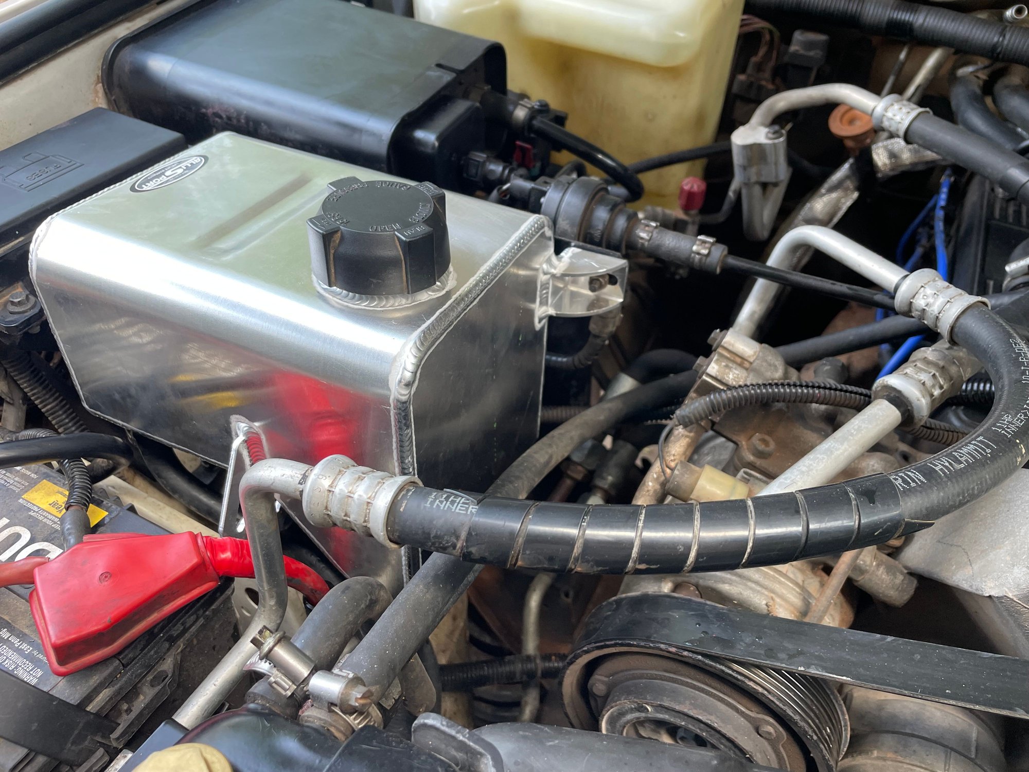

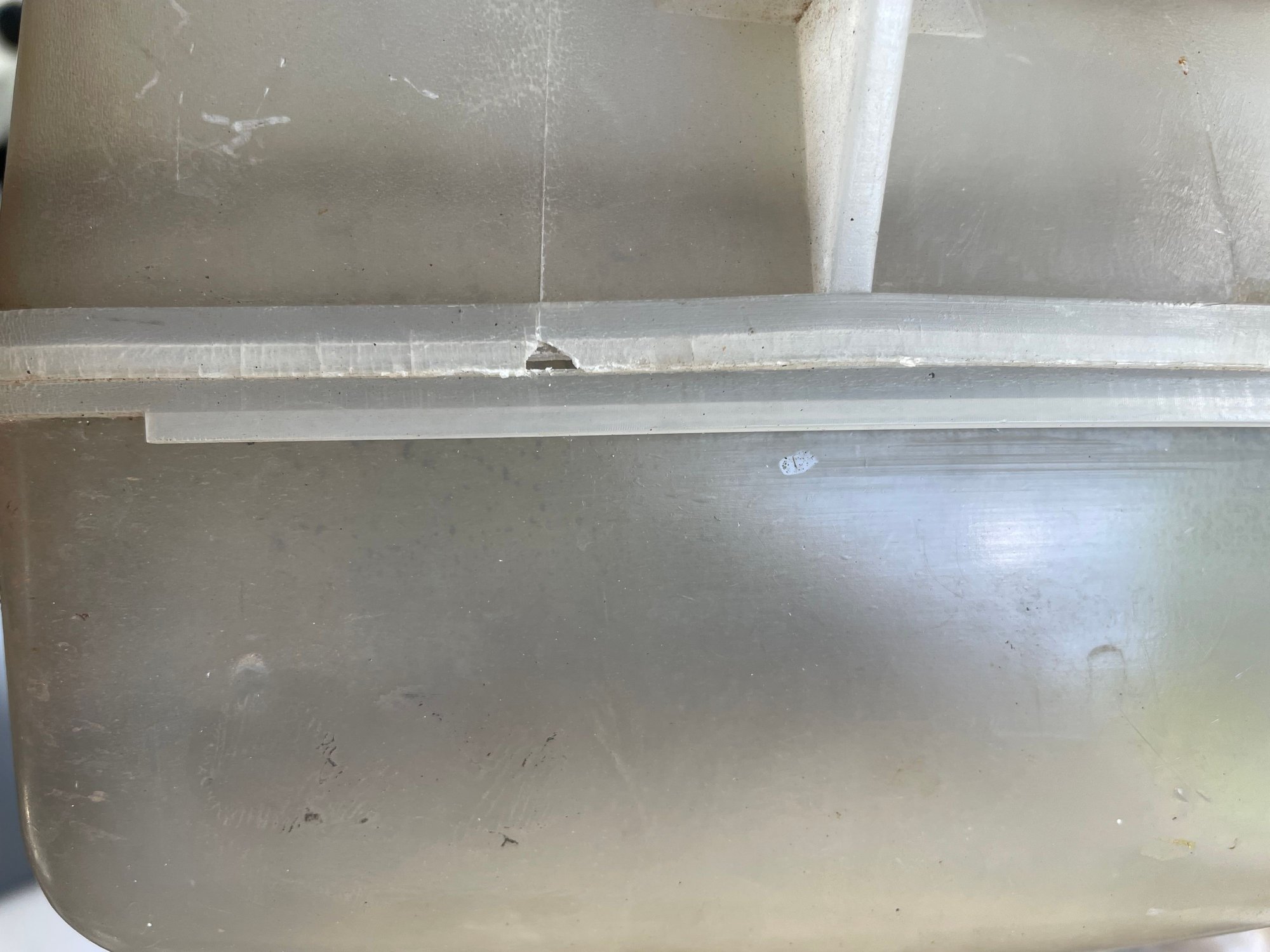

Put one in two days ago so I can’t give you a review. Got it from Lucky8. Allisport I replaced my factory with a new plastic tank about a year ago and was starting to split apart.

Good to hear from you. Thanks for the image!
I see you went with the stock pressurized cap?

I did for now. Time will tell. I will say, I wrapped my positive battery cable real good. This aluminum tank sits very close to the battery cable routing and conducts electricity.
