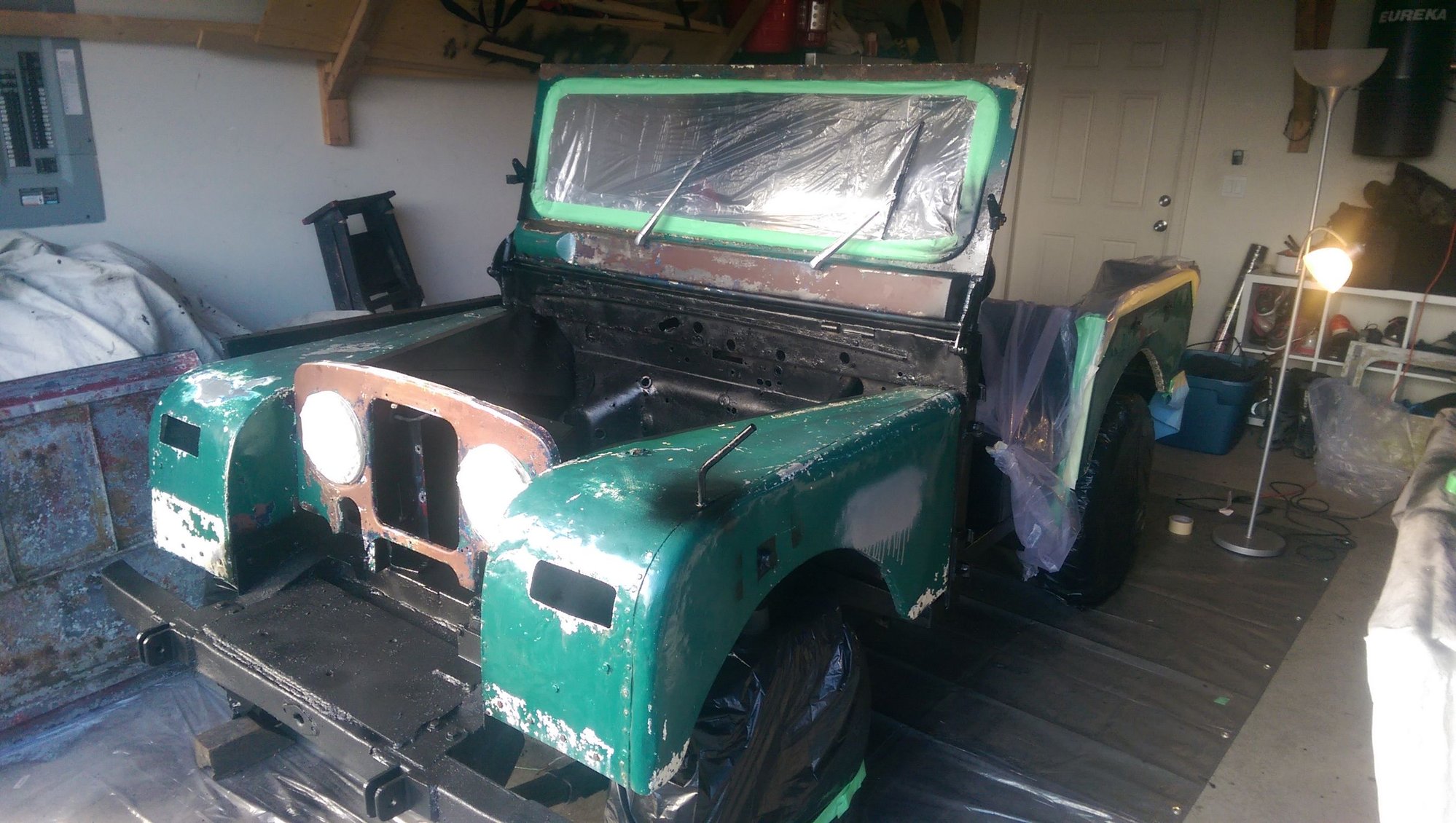

Spraying 7 coats on

Started to peel but the sun went down.

I'll post more pics once I get it all peeled off and re assembled. Peeling it off the rubber trim is extremely time consuming and really sucks. I would have masked it much different if I knew then what I know now. Any sort of rough surface or aged rubber (like every seal on a disco) grabs this stuff like crazy. Glass and door trim were cake but the window seals are awful to peel. Even with 7 coats there are areas fighting me pretty good.

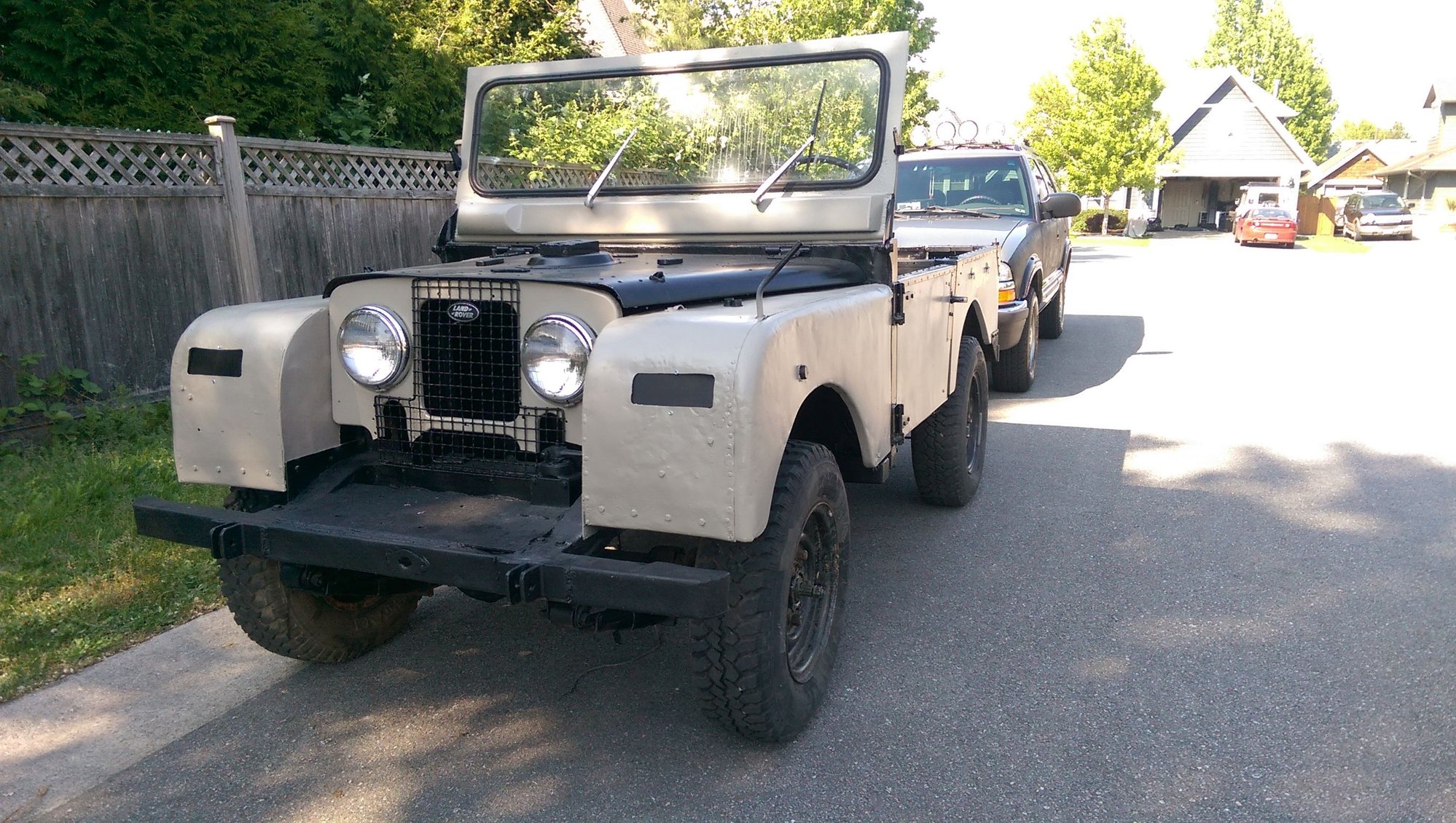

From: Vancouver, Canada
I dipped a S1 over a weekend. The truck is a roller for now so it just needed to look a little better to sit in our showroom. Cleaned up nicely and I don't feel guilty for painting over the original patina haha
