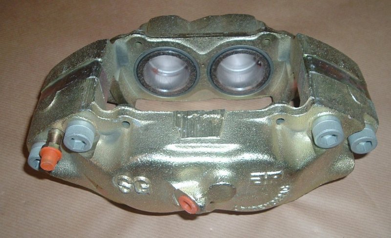

Old Dec 8, 2010 | 10:11 AM
kenk's Avatar
Joined: May 2009
Posts: 1,081
From: Punta Gorda, FL
Originally Posted by calebbo
I don't exactly know which way the brake pad "pulls out" but I think I can figure it out. Usually I will just remove the caliper and then change the brake pads.
You can change them that way, but to remove the caliper, the brake line needs disconnected, but since you're bleeding anyway, it don't really matter.
The pads pull out the big opening on top where the pins go through
