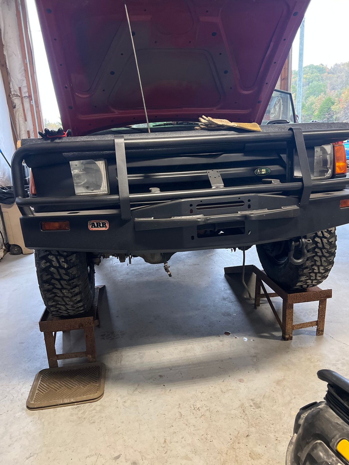

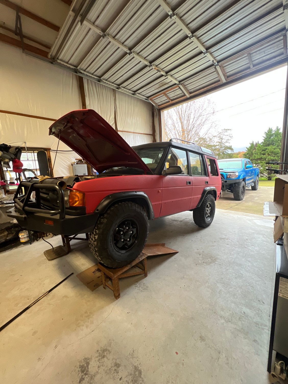

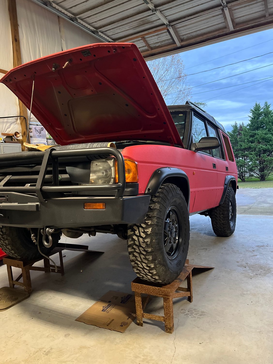

Hey guys. About to finish putting in the vinyl flooring and what not. Had the D1 up on some foot tall ramps while finishing patching the floor. I noticed there was some coolant underneath the vehicle, then I noticed there was some all the way back under the rear differential. Still assumed a small line leak or something. Opened it up today and the entire floorboard was also full leaking from the firewall area. Is this a heater core? It’s been on those ramps about 2 months. Not sure if I need to pull the dash out now and fix that or try something else. I just had the dash out and if I pull it out it’ll need replacing as the radio mount broke and it’s barely in as it is. I’m starting to get frustrated with this build after dumping 7k into it and it’s not even road worthy yet.
suspension was ordered tonight. +2 inch heavy duty TF
TIA!
