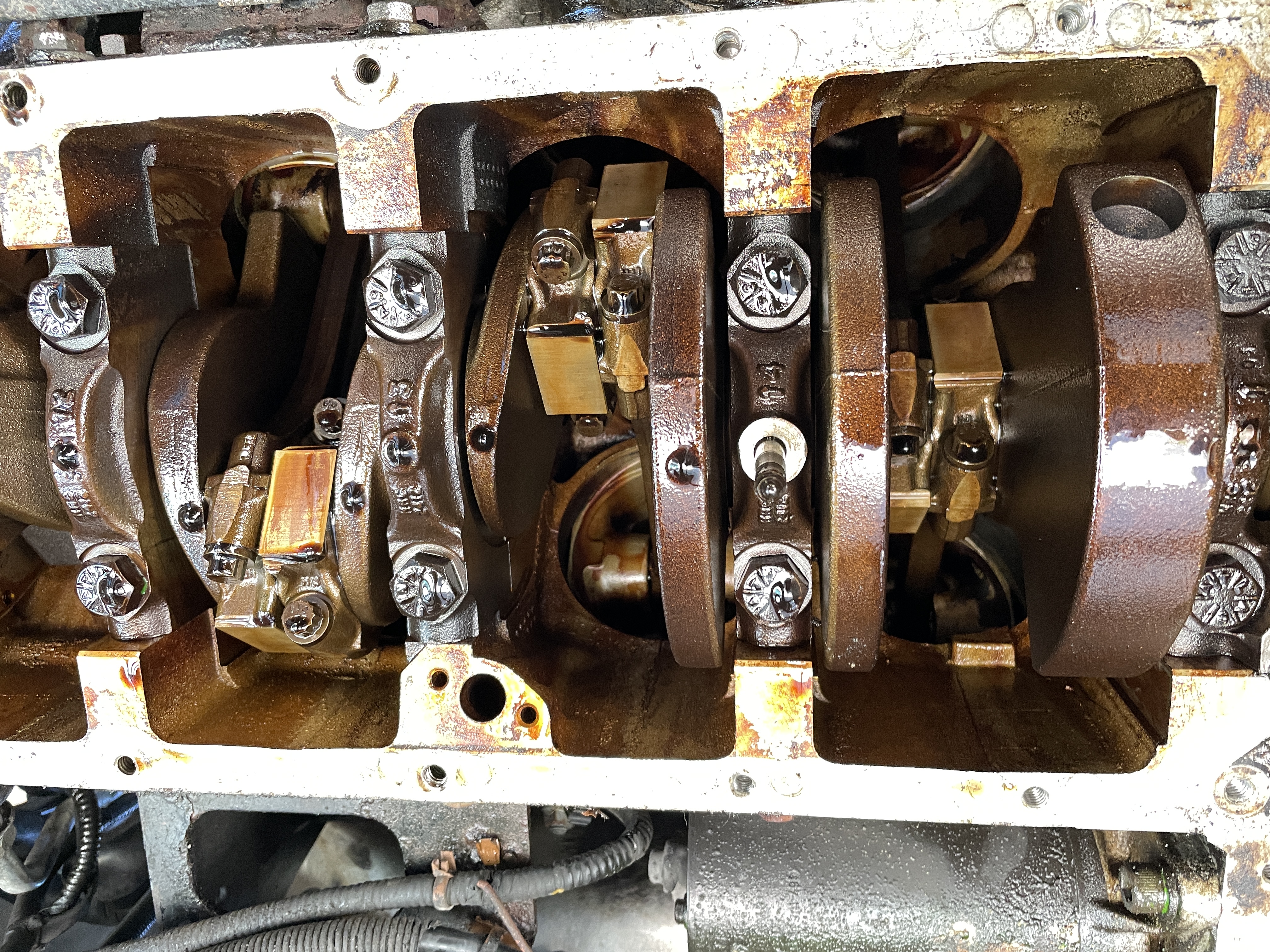

Thanks Harv and John! I drained the oil before I cranked the engine manually to see if I could hear the valve gasket spacer hit the oil pan. Good news, as I slowly cranked the engine, I could hear a metal cling hit the empty oil pan. I tried taking a magnet to the pan to see if I could drag it to the drain plug, but not luck. I can't imagine the metal spacer anywhere else after hearing the audible sound cling, but I am tempted to take the oil pan out to be sure.
John, I was trying to find schematics to better understand how oil drains from the camshaft to the oil pan. Do you know if there are large cavities for pieces of metal to fall through or is it tighter than that?

Oil flow is depicted in diagrams in the Workshop Manual. Maybe download it, look for any post by Walt from NY, links to manuals are in his signature block. Maybe search for photos of the underside of Rover V8s with oil pan removed. The cam shaft and bearings are visible from underneath. I just noticed there is a sticky up above noting Rave Manuals also available from Extinct Motorsports website.

link to manuals is in my signature. download docs and use as you please.
here is a pic of a 4.6 (P38) but it will be almost identical to yours....

Thank you, Walt! I was able to get my oil pan off and low and behold, the valve gasket spacer was sitting right in the middle of the pan. Quite the relief.

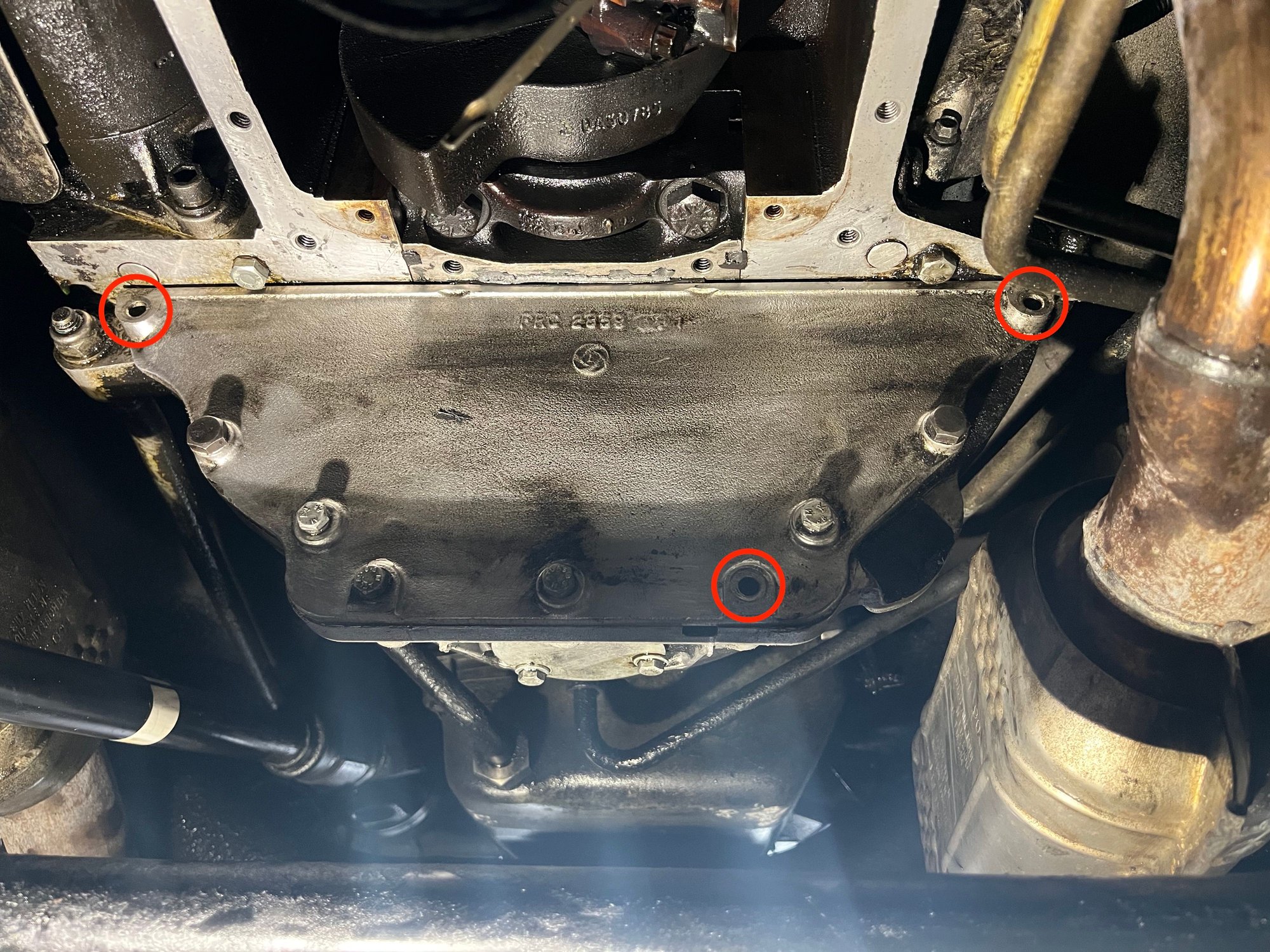

I've got most of the engine prepped and ready for the new heads. Been slowly cleaning up the engine block from the grime and taking my time to inspect all that I can. I noticed the flywheel cover was missing bolts, at least I believe this is the flywheel cover. Can anyone confirm? Is it weird that I missing bolts?
Would anyone know what size these bolts are?

Bolts are the same size as the bottom ones. The bigger side bolts are different. Maybe take the cover off and peek inside.
