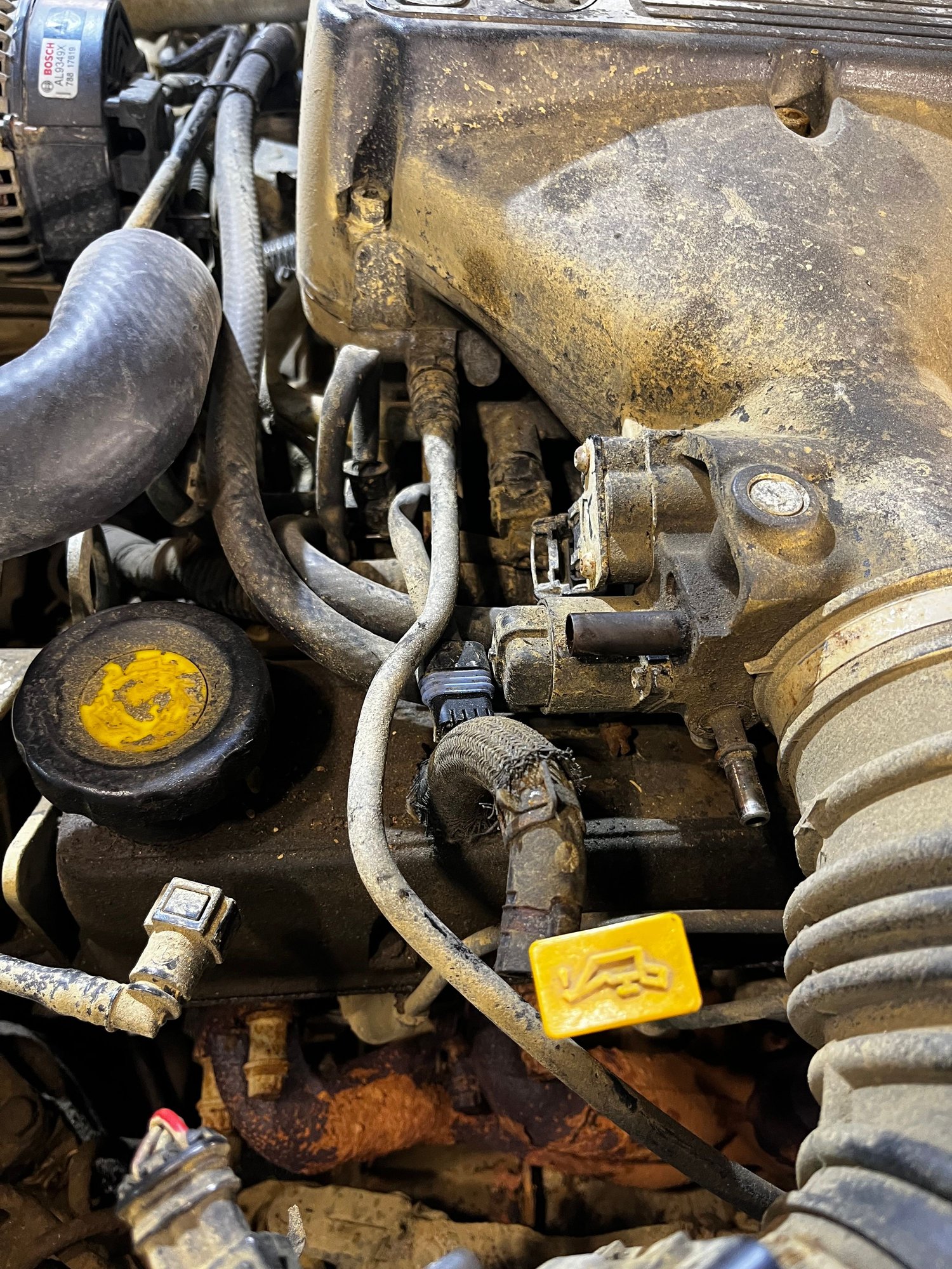

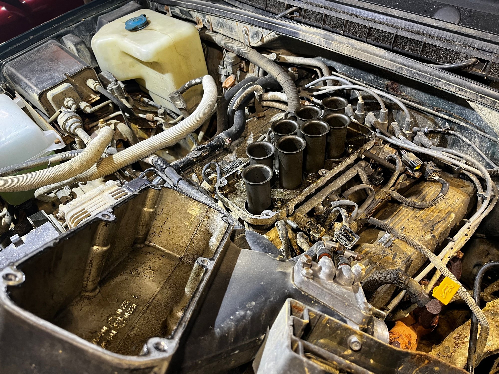

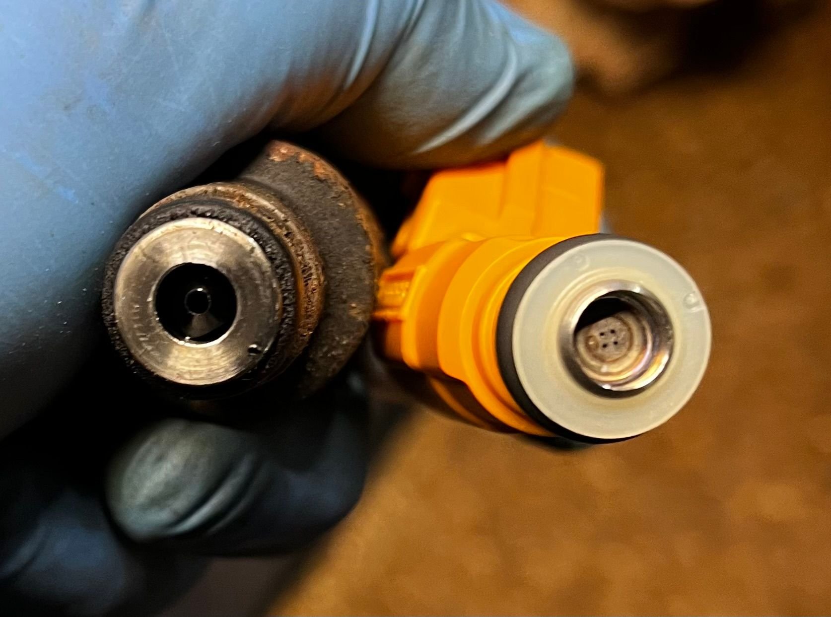

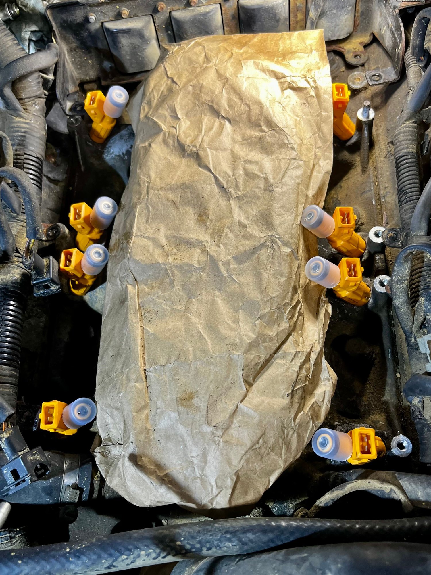

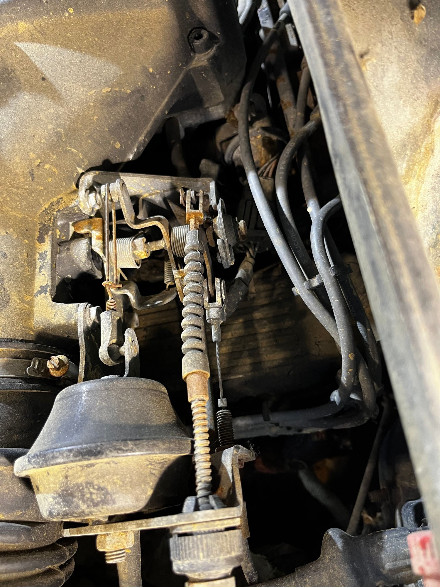

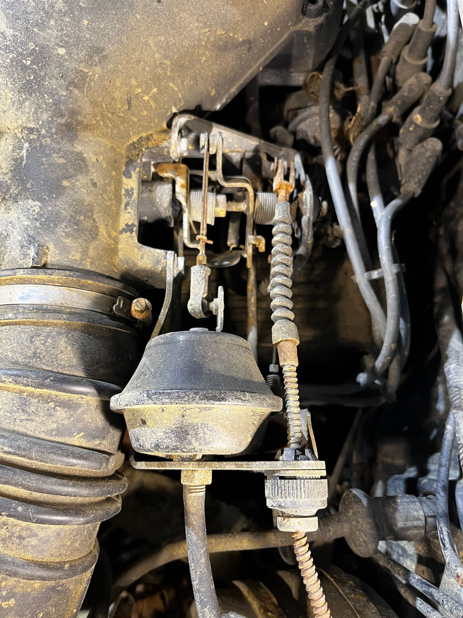

Just did this job a few months ago... swapped in some Volvo injectors as a slight "upgrade". Don't need to remove the FPR but you will need to open the feed and return lines. A good set of flare nut wrenches will be indispensable here. As far as cruise/throttle linkage, I followed the instructions in the factory shop manual and took reference pics beforehand. Wasn't as bad as it looks - actually you really don't have to touch the cruise stuff, other than pulling the vacuum line off. It's really the throttle/kickdown cables. Here's a few pics of mine....
