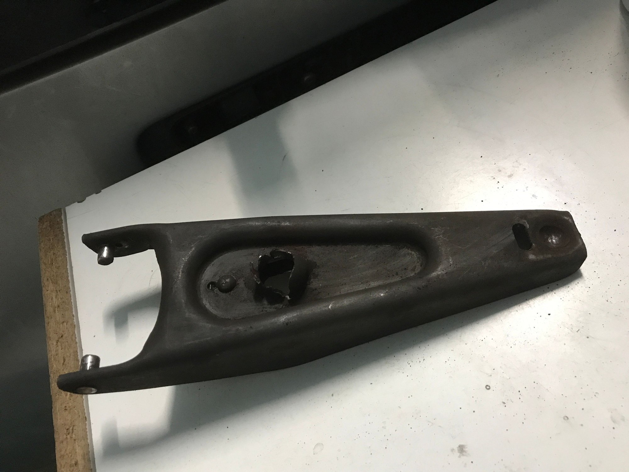

Default Clutch lever fork punched through
Hello,
As for (to) many Disco’s before, it was again the pivot pin which had finally pounced through the clutch lever fork ! See picture. It just happens, no matter what your drivestyle is, told my garagist. He hold always a small stock levers, just in case. On the clutch plates (after about 170.000 km) were also traces of beginning wear, so my garagist has replaced them.
The replacement lever forks now are reinforced, those of Land Rover
Lever pivot pin punched through lever fork
