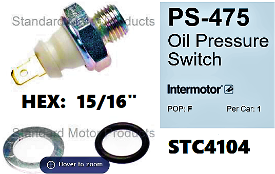

What color is the new oil pressure switch? Black plastic with gold body and it's a smaller 7/8 size vs the OEM white plastic with a silver body and 15/16 size? Sounds like the URO el cheapo... I recently had slapped one onto my 97 XD because the OEM white/silver one was leaking. I got the URO replacement from Rock Auto (was not labeled as a URO on their website). I slapped it on, and the next trip into town I saw it flash at a stop light..... I about passed out after all the work I'd done on the XD. Well my brother relayed basically the same story I am now and he said to get another OEM style unit. I did and bingo no more flashing light.

Yup that is correct. I got the $4 black with gold switch. I work at a Mazda dealer and just gave a list of parts to the parts guy, he ordered me a bunch of stuff. The leak is gone but the light flickers. The old switch is the white and silver. I did an oil change last night and for fun switched the old switch back in. Drove home and no oil flickering light. A little oil puddle though in the morning. I will be getting a proper switch today.

Stc4104

So I should be looking for the OEM white plastic with a silver body and 15/16 size.
Should I also be looking for one that contains both a washer and o-ring?
Just trying to stay on top of my parts collection for that rainy day.

It's a very good idea to stock up on quality parts well before you need them.
In this case get a Standard Motor Products (SMP) P#: PS-475
I've used these for years with zero issues. Some actually come stamped "STC4104" on the bottom.
And YES use both the washer and O ring.
I only have ONE WARNING re: this little sensor..... when you install DON'T Cross thread it OR Over Torque it!!!!!
It's very easy to do both of those things and can result in a crack in the threads. I've seen this happen more than a few times.
BAD DAY because that means a NEW front cover.
