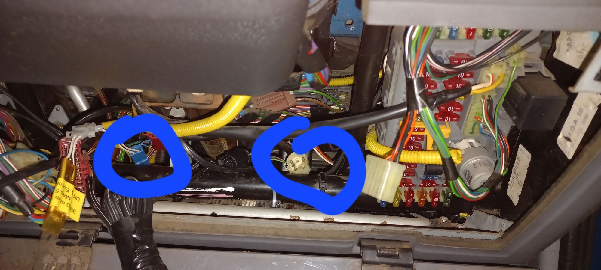

This pic is directly under the steering wheel.
The left plug is the tune resistor plug, though I've extended mine to the white plug and resistor to the left of it.
The right plug, is the diagnostic plug that Rovergauge uses... but I've added the plug to the left of it, which I have on my Rovergauge cable.
Theoretically, yours should be in vaguely similar positions, but may be lightly taped to the loom.

Yes I am in NZ, I’m in Christchurch.
I’ll have a scan tomorrow and hopefully my plug location is the same as yours. I believe mine is a UK import so there’s a chance it’s different 🙃 but once I find it I’ll take a photo for anyone that may struggle in the future.
