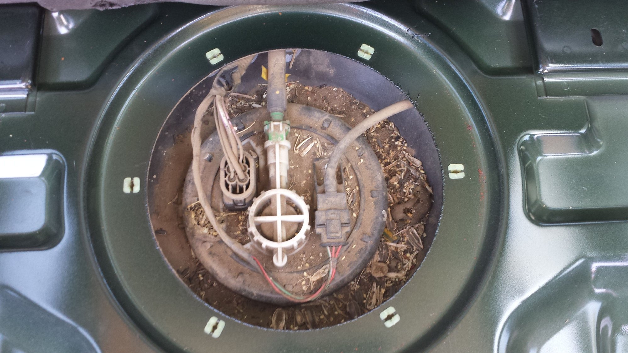

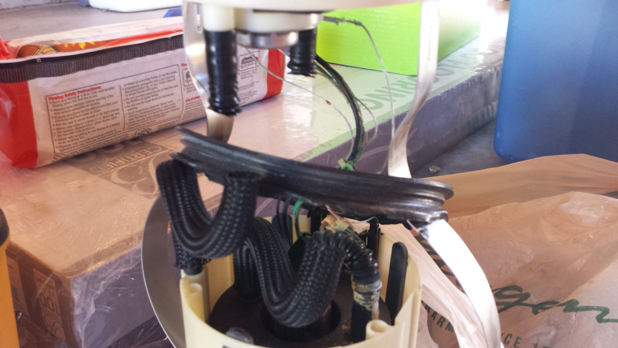

The job is pretty self explanatory. The only hard part is getting to it under the rear carpet. I ended up making a hole in the carpet so I could get to it in the future without removing all the rear interior.
My only advice would be to make sure that large o-ring is in place first before fully dropping down the fuel pump. That sealing ring wont seal unless the o-ring is put in correctly.
