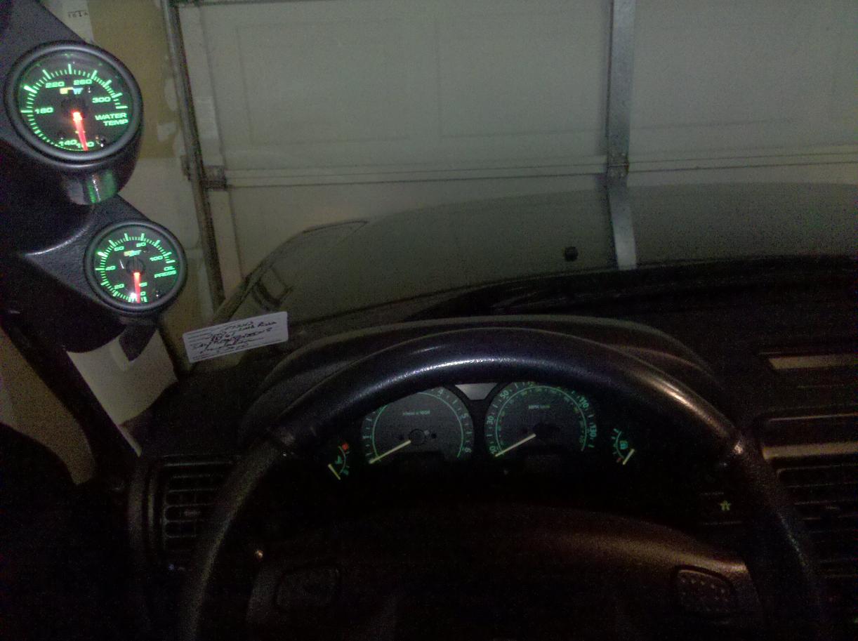

http://www.glowshiftdirect.com/black...ure-gauge.aspx
I mounted water temp and oil pressure gauges on the a pillar right above the tweeter in a ..you guessed it, glowshift brand two gauge pod.
Old Jun 22, 2010 | 01:47 PM
JerrodSteph's Avatar
Joined: Sep 2008
Posts: 138
From: Dallas, Tx
Here is a pic
