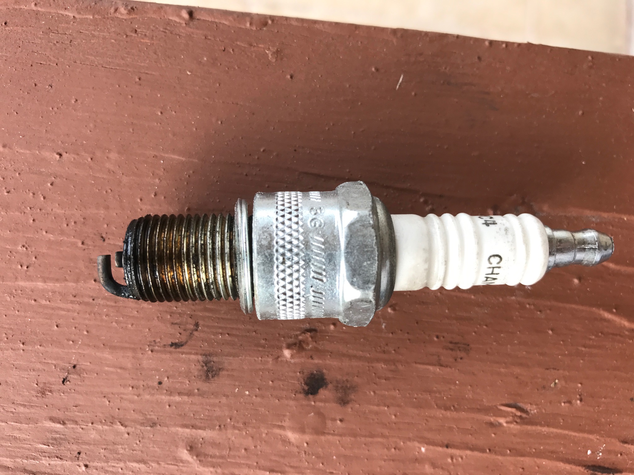

Posts: 49
Here are the pictures of the "1" and "7" plugs. I could not get to the "2" and "8" plugs because I would need a ratchet extension. Let me know if you guys need to see the "2" and "7". I just realized I should have taken out spark plug "3" to compare (do'h). I'm sure the plugs look gunky from the Gumout, BG 44K, and the decarb I did on the engine. I also did a Rotella T4 15w-40 oil change today with a Motorcraft FL-1A large capacity oil filter. It helped somewhat with the ticking.
Hmm interesting, plugs look oily if anything.
might want to make sure the pcv valve is still there and hasn't been replaced by a hose. Have you checked your viscous fan resistance, and the electric fans. And is oil still mixing with coolant?

Posts: 49
Where is the PCV valve you're referring to? I only know of 2 pcv lines. One is on the driver's side valve cover that goes to the throttle body and the other one is on the passenger side that hooks up to the intake manifold, if I remember correctly. There are also two vacuum hoses, one on each side of the intake manifold cover. The viscous fan seems ok, I guess. The fan does not free wheel when I spin it while hot (quarter to maybe half a turn). The overflow and radiator bleed screw coolant looks bright green, no traces of oil. I haven't checked the electric fans because I've had the ac off the whole time the truck runs. Do they turn on as well when the engine is hot? I thought they were only there to cool off the condenser. Thanks mr4x4
