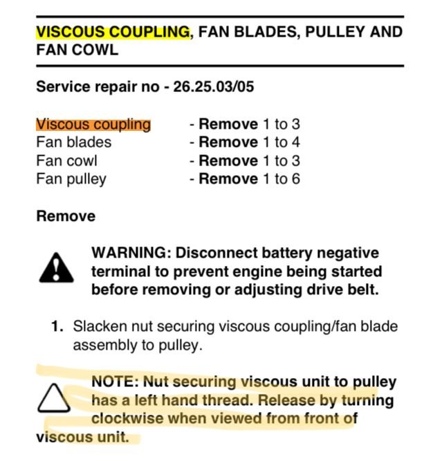

thats interesting because I’m seeing this:
that is not for the 4.0 V8.
see the image below.
page 365 in the pdf. section 26.

Disconewbe,
you are looking at the Viscous Fan removal for the TDI engine.
the RAVE manual has both the TDI and petrol/gasoline V8i in it. it can be confusing at times.
