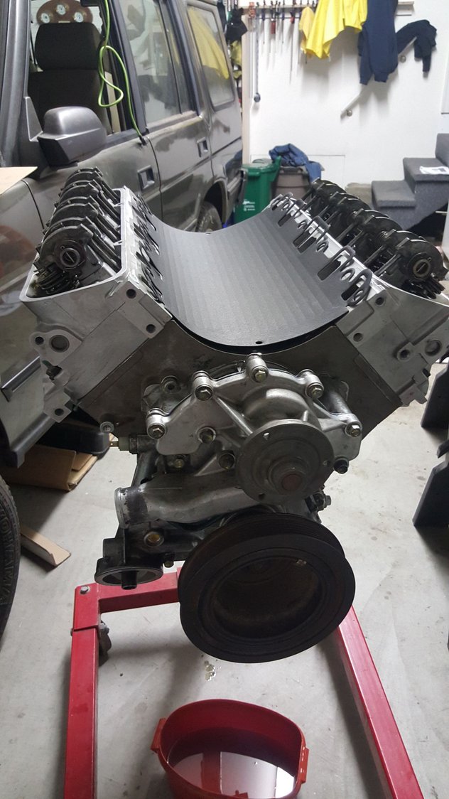

From the RAVE overheat troubleshooting it appears to me if I am good but someone perhaps can confirm from the pic below. The RAVE says the fan should be "concave side towards engine".
Thanks

As for the shiny engine - here is a better pic
On other news, I threw a pending code on my way home p1179... Sighs ... No CEL yet though. I had sometimes needed to crank a couple times when cold starting so I had a leaky injector in the back of my mind. Perhaps the cause. I have an extra intake sitting from my old engine so can always swap if needed. Also have an extra MAF sensor I took off a parts truck just in case ($10). And the front O2 sensors are new. Either a vacuum leak or leaky injector I hope....
