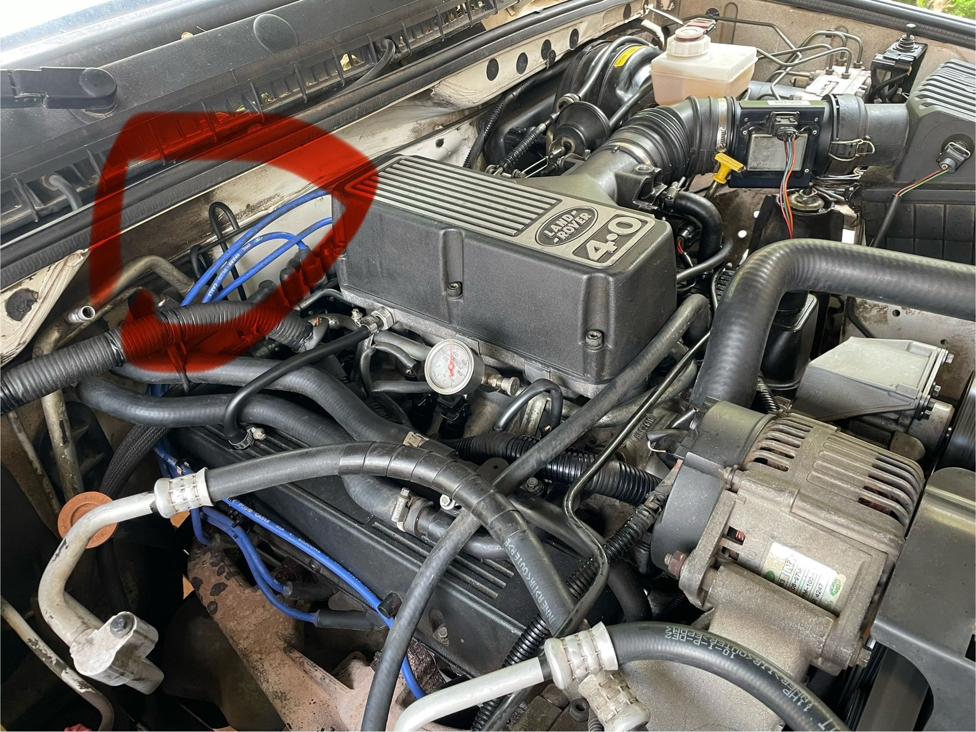

I checked the vent tube. Pulled the banjo bolt off. It had some junk in it but I don't think it was clogged. I took a can of Berryman's B12 and blew out the line from the top. I was surprised to find the vent line only goes above the tire in the driver's side wheel well. I thought it was one of the two I have on the firewall. I pulled the top loop around so I could spray cleaner into it. I put it back after I took the pic.
I'm going to pull the filler plug and see if oil/grease pour out.
Thanks for the tip on checking the vent tube.
dcphotos

From: SE Washington State
Mine ends up behind the motor in the engine bay.
One melted on the exhaust manifold.

I have two vent lines on the firewall. Are you sure your front axle vent doesn't terminate in the wheel well like mine?
I'll trace the firewall vents and post what I find unless some chimes in and say what they go to. I'm thinking one is transfer case and the other Auto Transmission?
dcphotos

Those vent tubes look like mine. On both trucks, my front axle vents use the same clip as in your photo above, but go into the engine bay several inches up, so the hooked end vents straight down, a bit below the brake booster.
Here's a way to check for plugging without disassembly: Use a clean piece of tubing and blow into the vent tubes, the spaces should pressurize slightly and blow back out when released, acting different than a blockage. These tubes vent pressure changes due to varying temperature, so there is very little flow and even a partial blockage is no problem. Only a problem if completely blocked (think melted on exhaust manifold), then pressure increase due to rising temps can cause oil leaks at seals, or worst case dislodge seals.
