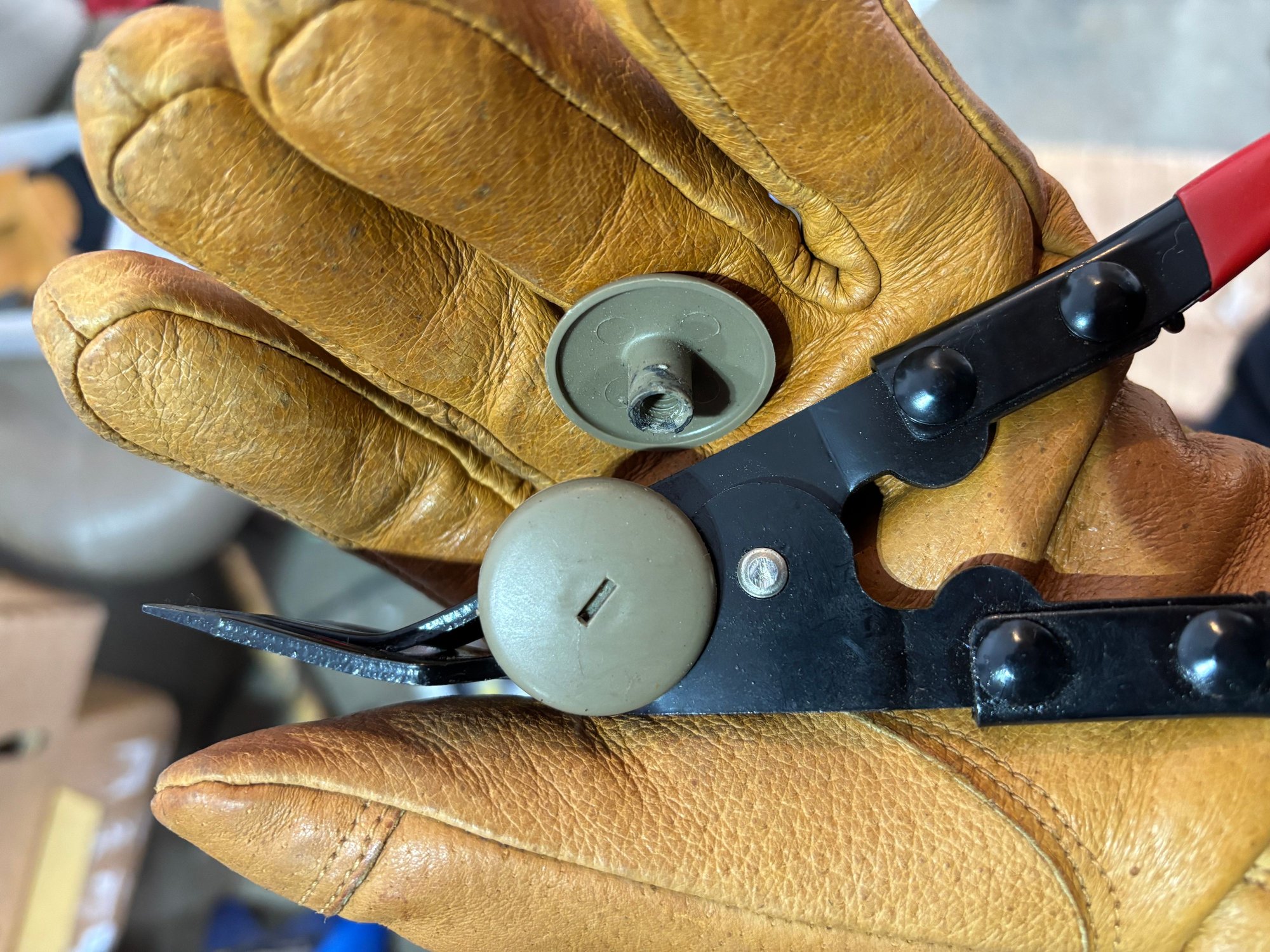

Hi all,
looking to understand what part I need for the footwell trim retaining clips/plugs. You can see there is a fixed stud inside the hole. I found these but not sure they are correct. Too short.
if they are correct then does anyone have the part number. As always thanks so much!

They are supposed to be threaded onto the studs, but when they get pried off, the strip out inside.

Maybe ask a LR dealer? Or a scrap yard? The actual pieces are about twice as long as the ones pictured, with springy sides that allow it to be pressed on. I guess the slot is there to clue us in that it needs to be unscrewed to remove. Sorry, I have no part number.
