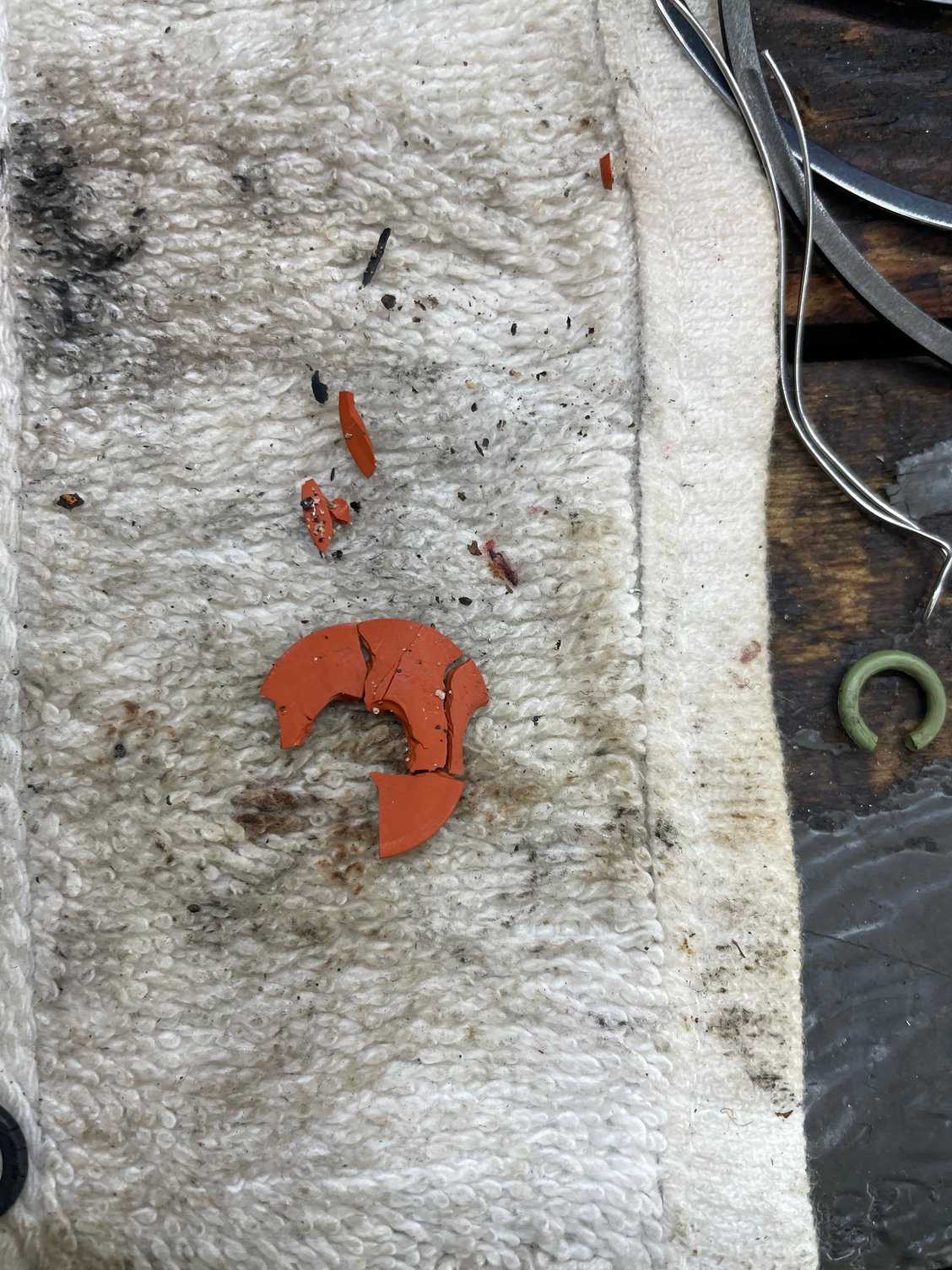

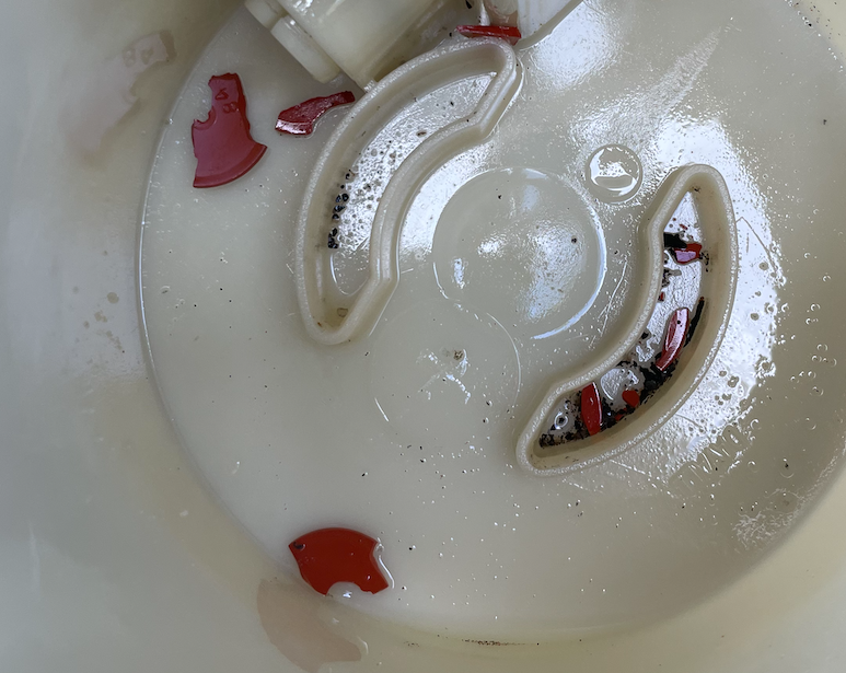

1997 D1 w/AEL - Found this in the swirl pot of my fuel pump. Pump was working fine. I'd been getting a P0451-Fuel Tank Pressure Sensor Signal Error Fault.
I swapped for a new pump but found this inside my old pump.
Any ideas?
TIA
dcphotos

Just a guess, but could be a small washer-type seal for the old pressure sensor. Otherwise, came in through the filler tube.

I pieced it back together as best I could. Not even sure if it’s correct.
It does look like a one-way check valve/flap.

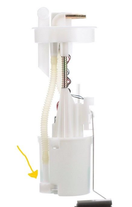

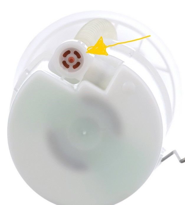

Probably this ...

hrhoward,
Must be it! Thanks.
I looked at all the exploded diagrams I could fine online but did't see that.
dcphotos
