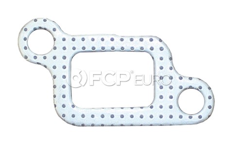

There are several kinds of gaskets.
A multilayer (you can see the layers) thin smooth metal one that has embossed ridges and is one gasket for two ports. Another is of a sandwich construction that is dimpled and is one gasket per port but usually has sealed edges.
Another that covers two ports but is dimpled sandwich construction, also with sealed edges.
Sounds like you got the first one.
First type
Second
Third

Default Makes no sense to me
I phoned Atlantic British, and they told me that the thin metal gaskets are meant to be pressed together. They are supposedly used however I need them as shims. So I guess I ruined them. None are perfectly flat (aside from the embossed edges).
Of the pics above, which kind should I buy to replace them?
