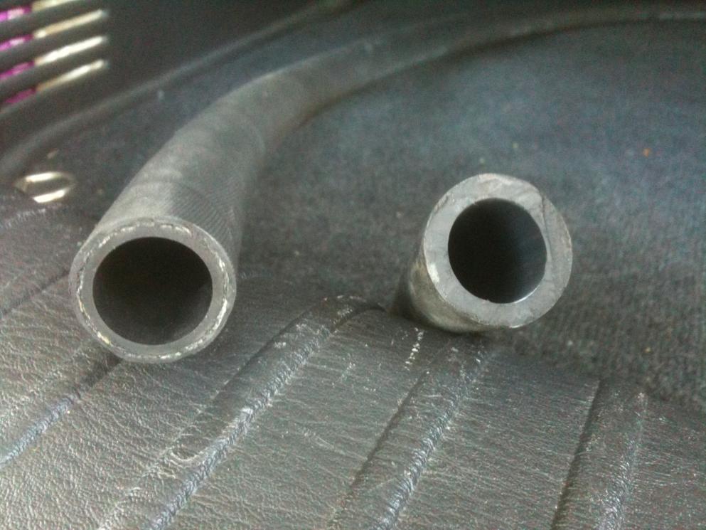

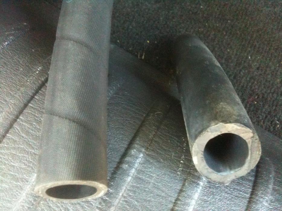

Alright, I bought 4ft just in case. Next will be the filler hose, which is $17 a foot. Will be getting that from another shop tonight.....
Left is the new, right is the old crap....
