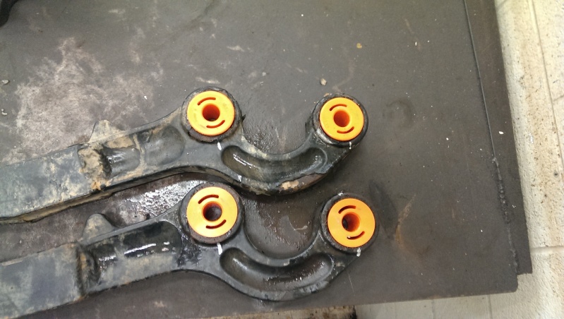

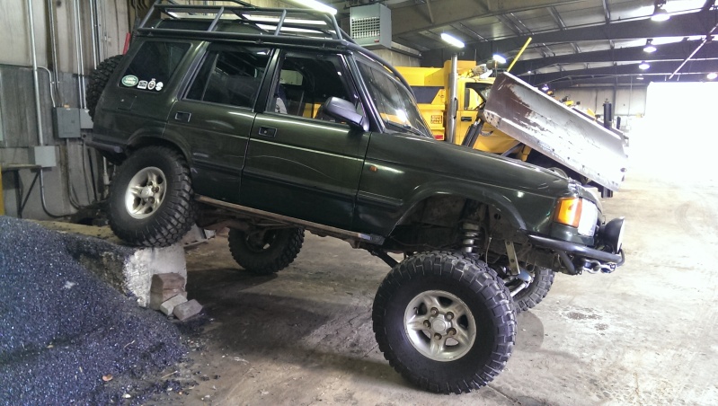

I'm a big fan of the Orange PolyBushes. Justin @ Lucky8 recommended them after my AllMakes frame side trailing arm bushings lasted all of two days, I'm not kidding. The Orange Polys lasted a out two years. They took a lot of abuse in those two years and I'm satisfied with how long they lasted and performed. I also have the Orange at the frame side on my radius arms. I just recently got the Orange slotted radius arm bushings for the axle end to give me more articulation. So far I'm very happy with the results.
I think you'll be happy with the Orange PolyBushings. Use some soapy water to ease the installation.

Iirc a few of the bushings took all 20 tons of my press to get out, I have orange from I think rovers north? Not slotted like infest In pic
