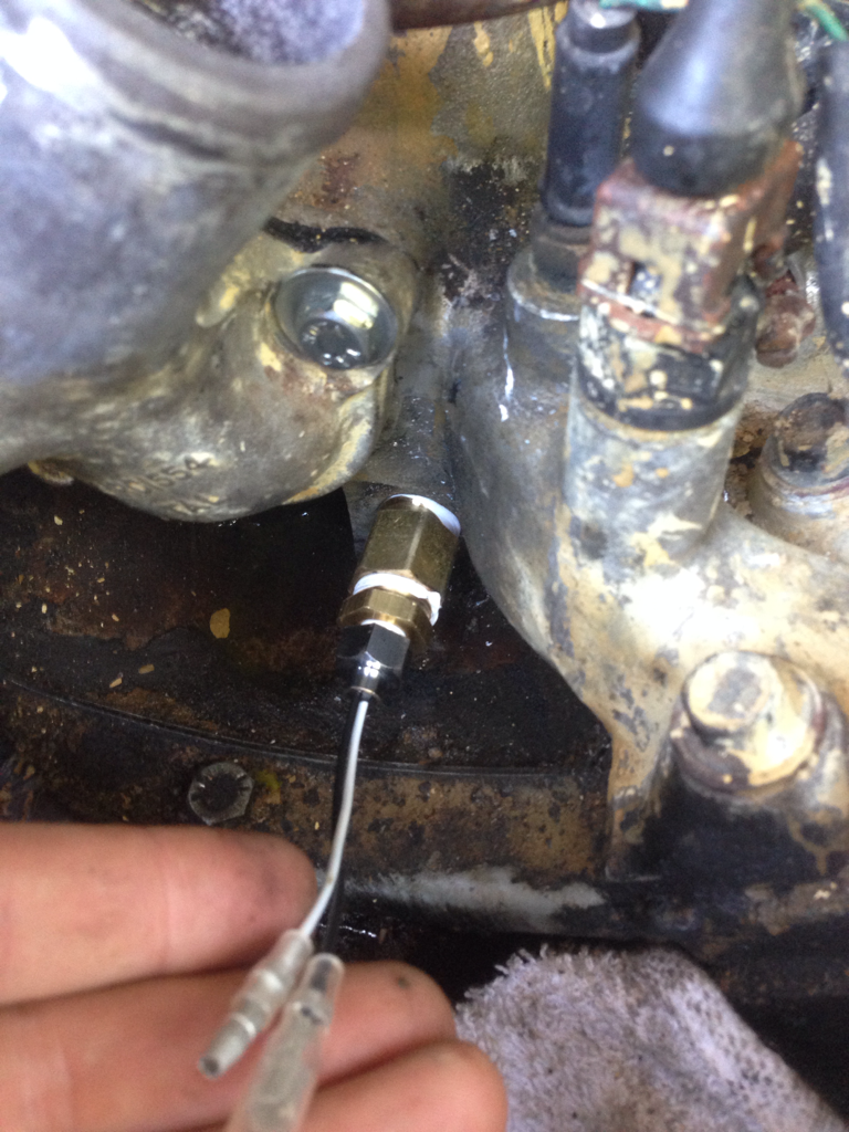

Go to home depot with both ends in your hand.
Buy pipe adapters.
Put together with blue or red loctitie.
Done.

Tom, what's wrong with the picture MM3846 posted? Look's like a simple and easy way to get the job done.
The sensor reading may "lag" slightly by not being directly in the flow, but it should work just fine like that.

I have yet to find a reliable small switch like in the pic, that's why I use the Chevy type, I have the standard Chevy one adapted but the lower temp has a larger probe and won't work i n my home made adapter
