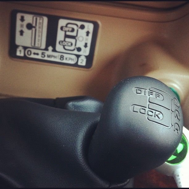

If there is any confusion regarding the position of the lever as it controls the CDL, the lever in this picture has the CDL in 2HI, ("down and right") which positions the lever the right (passenger side) of the vehicle and away from the engine.

Um Walt got it pretty close for horseshoes.....
It's 4HI Locked, 4HI Unlocked, 4LO Locked, 4LO Unlocked. Stick to the right is Locked, stick to the left is Unlocked. I'm pretty sure there isn't an issue here with the sun gear welding itself in a large mass since the OP said it was in 4HI and came out of gear into transfer case Neutral. It's happened with mine when playing and the shifter block and linkage just needs a little TLC'ing which is as common as breathing.
Just for the record you can switch between 4HI Unlocked to 4HI Locked and vice-versa at just about any speed the Disco can go. I do it all the time in the winter depending on the roadway conditions. It can be done on loose terrain as well. LO is the only time your required to be at a very reduced speed, tranny in neutral (to reduce internal spin) as it relates to the rotational speed of the low speed gear set lining up enough to make the change.
I'm pretty sure this is backwards. Pushing the lever toward the left (driver's) side of the truck locks the transfer case.
Down (rear) and right (passenger) is the 'default'.... High and unlocked.
