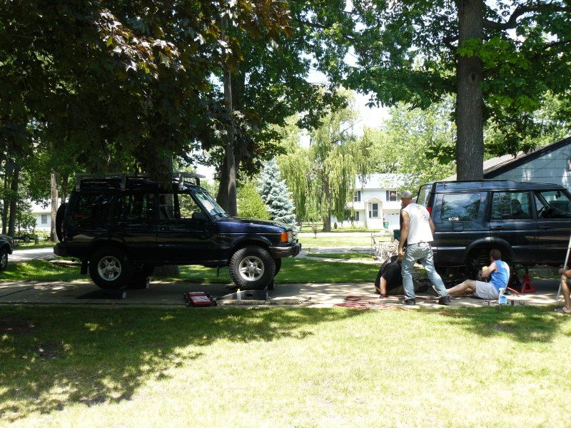

They're not that bad. They actually look pretty good. My buddy just put 235/85/16 Goodyear DuraTracs on his D1 and they look really good. Its the one on the ramps in this pic. His front bumper is slightly tweaked, normally the plastic wouldn't be that close.
