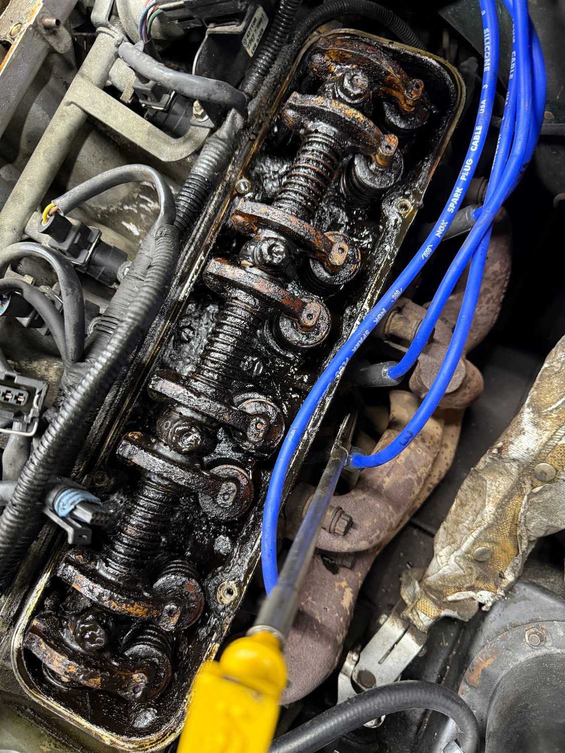

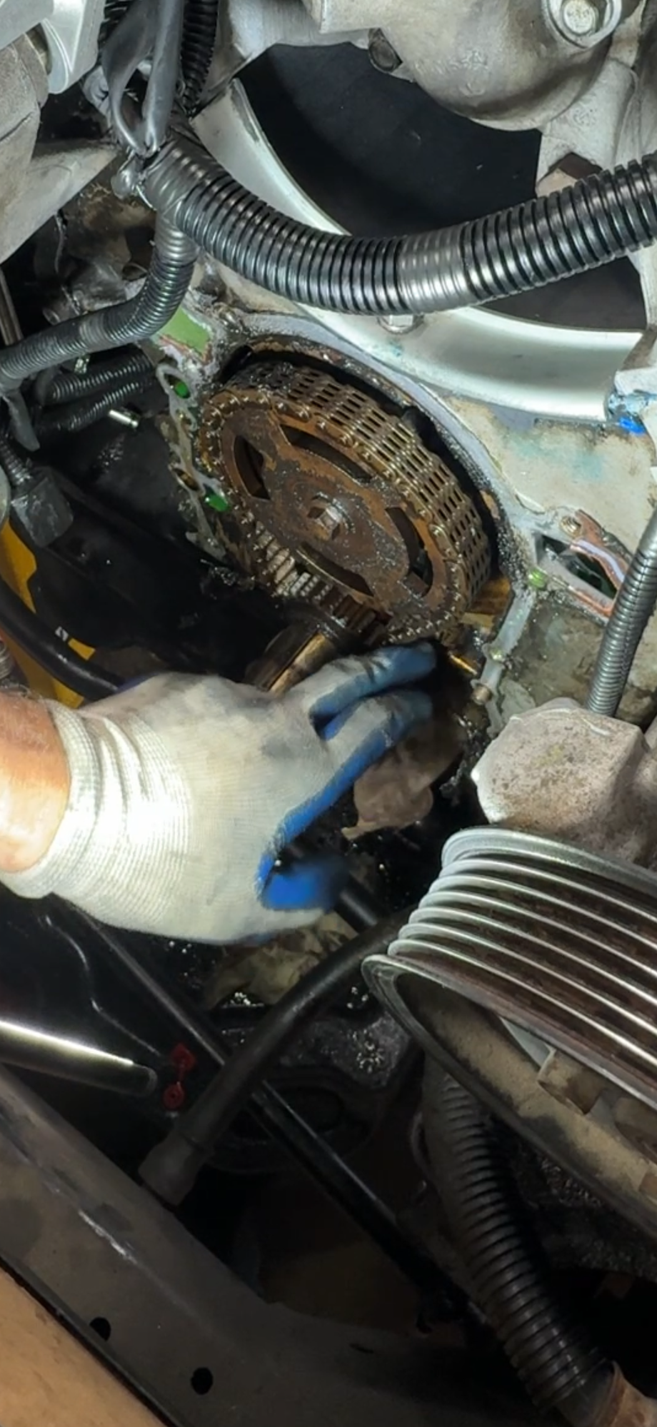

I started with cleaning the top of the engine and working my way to the bottom. I replaced tappets, re sealed everything and moved to the front of the engine...I'm honestly shocked that timing chain was functioning at all, I posted video how loose it was at the D1 Facebook group, but here is screenshot (chain was flopping left and right - no resistance at all).

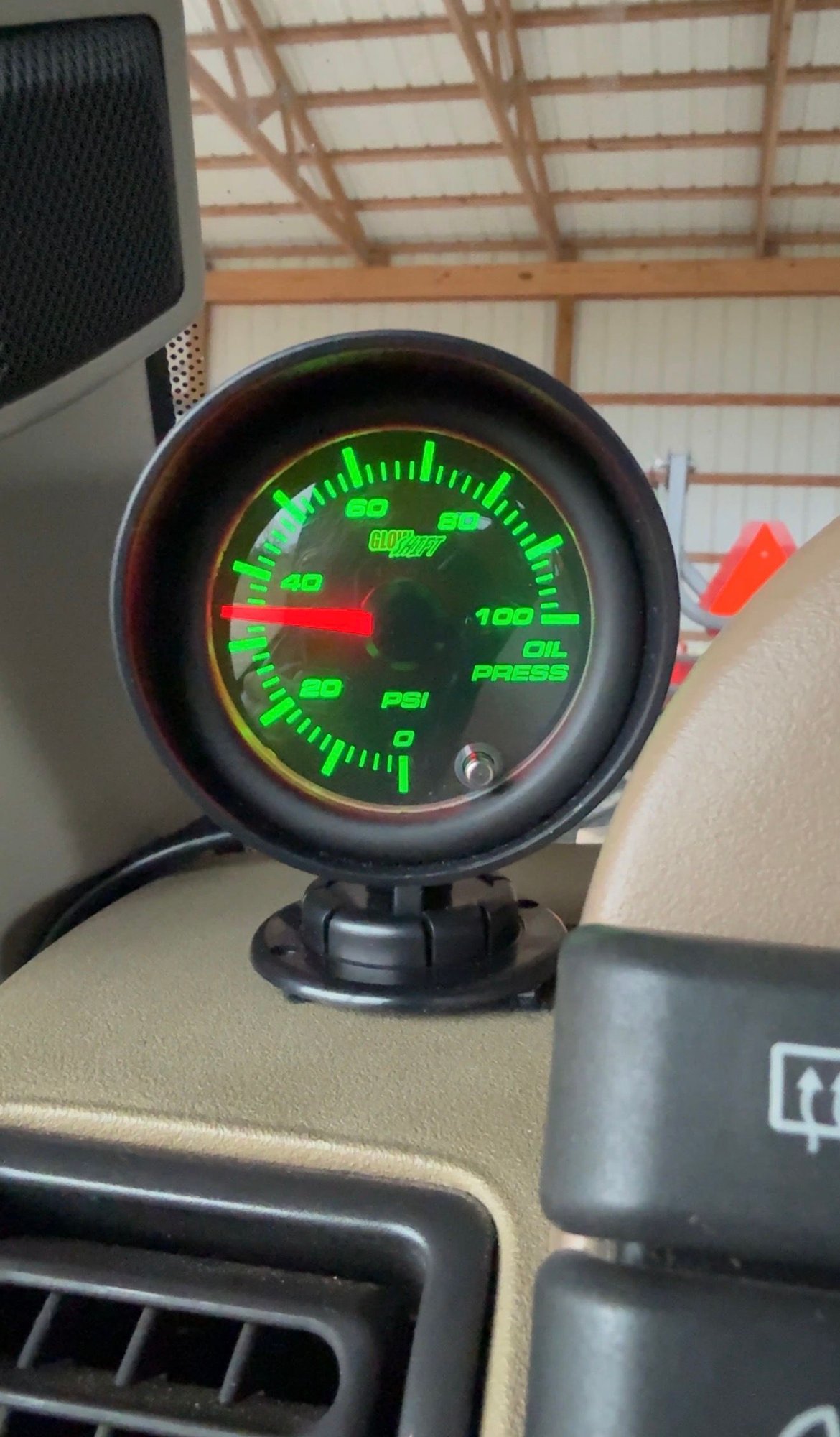

I replaced also oil pump gears and water pump while at it. At that point I decided to add "sandwich" plate to the oil filter and place oil pressure gauge inside the cabin
For those who geek out about numbers, with Valvoline 5w30 (restore and protect), I was getting 29 psi at 2500rpm when engine is at normal operating temp.
Per Rev manual, At a steady engine speed of 2500 rev/min - engine oil pressure reading should be - 39.8 psi. I know that i'm not within the spec on my front cover and oil gears in one spot (that's going to be corrected soon, i just had a hard time finding D1 engine front cover).
Just for kicks, i switched to Castrol 10w40 and that resulted in slight boost in oil pressure (roughly by 3 psi). My hot idle is at 15psi, so i'm not tripping oil pressure warning light, but I'm only at 32psi at 2500 rpm. So, this will have to get corrected in the future.

Overall, I think D1 4.0 is not bad all. I'm convinced tho, that lack of basic maintenance (timely oil changes), absolutely contributes to many problems with those cars...amount of the sludge i removed from my engine is just scary and I know that I couldn't get everything out.
I'm hoping that frequent oil changes will eventually help to clean this motor...time will tell.

Pretty nasty inside. Glad you did your magic to it. Compression numbers seem pretty good. Sounds like you got a decent rig. Given the miles, I'm surprised you didn't pull the heads while you were in there and put on new head gaskets? (or maybe you did)
If it makes you feel any better, my Hummer H3 has about 10-11 psi at idle and 26psi going down the road. It's been what way probably for 8-9 years?? Maybe longer with the PO. Sun still comes up in the morning. One of these days I'd like to rebuild it. I think I remember seeing 10W-40 oil recommendation in the owners manual ....if I remember correctly.
I wonder if your engine has some sludge on the oil intake?

I hear you Mark. Reason i didn't dig into the heads yet, surprisingly truck holds temps extremely well. I'm running it with the external scanner, so while driving, temp hoovers around 176F (!). So when cleaning everything out, I checked for any leaks on heads, couldn't see any, so I went with the "if ain't broken, don't fix it" approach. Also, honestly, after few oil changes, I want reopen rocker covers anyway to see how we are doing with the sludge, to make sure all is staying relatively clean. Worst case, I will then rip everything out and do camshaft, bearings and heads and front cover machining at once...we will see. So farm this Disco is a fighter, so i will keep it in the fight as long as i can, ha!
