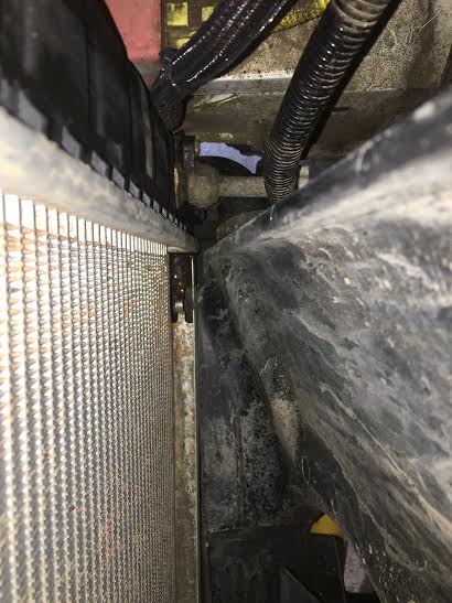

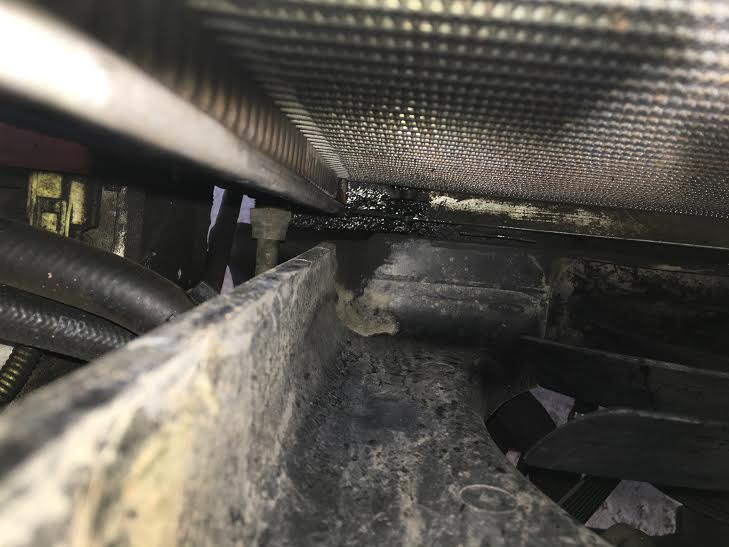

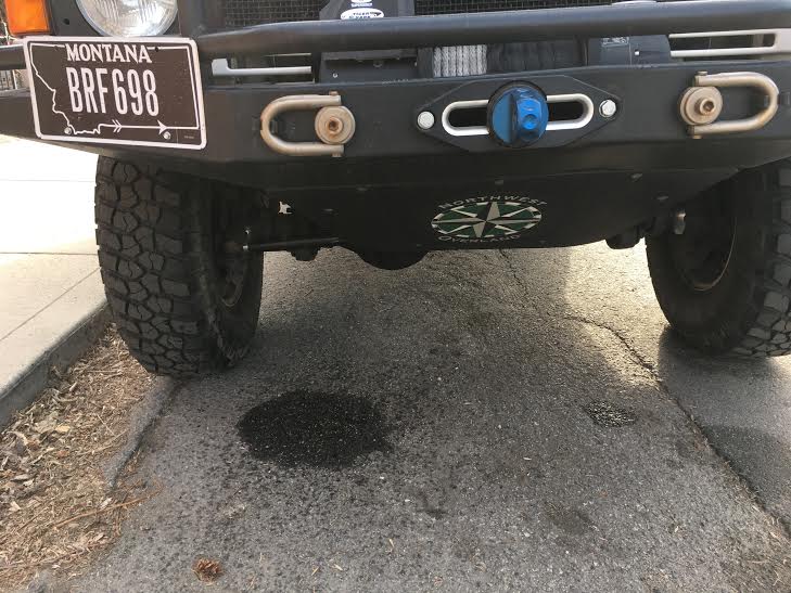

So I noticed that there was a puddle of leaking stuff under the front of the Disco. There is a larger one on the pass side front and a small on the driver's side front.
It tastes like radiator fluid. I crawled under and could see a small amount on the frame rails. I felt under every hose and connection I could find and could not feel any liquid.
I pulled the fan shroud and peeked down in and there is leakage it appears from the radiator.
The radiator is 2 years old.
Am I missing anything? Somewhere else to look? As you can see the leaks are very far forward.
Let me add: I did not smell any radiator fluid. I took it on a pretty heavy 200 mile round trip yesterday and each time I stopped I did not smell any coolant, nor was there any steam, nor did the temp gauge move above center.
It also doesn't leak when stopped. I checked about 20 minutes after parking yesterday and no leaks. Woke up this morning: leaks.
Thanks.

You need to have system pressure tested, keep it full

No leaking overnight. Went today and got a dye to test it but it's too bright out to see. Also changing from DexCool to the green stuff.
Maybe it just decided to fix itself!

I would guess it might be a hose. best bet is to get a pressure test on it. I got one from Amazon that has adapters to fit all my cars so that makes it more affordable (in my opinion)
Amazon.com: Mityvac MV4560 Radiator/Cooling System and Pressure Test Kit: Automotive Amazon.com: Mityvac MV4560 Radiator/Cooling System and Pressure Test Kit: Automotive
Running low or out of coolant will do a lot of damage and is not worth taking a chance on.

Thanks for the link. Of the four auto stores in my town only AutoZone had those for rent and theirs didn't fit the cap.
I definitely don't think it's a hose. I traced all of them with a paper towel looking for any leaks and didn't see any. Looks like it's at the ends of the radiator under the plastic parts - which sucks as the radiator is only 3 years old.
I'm keeping a close eye on it for now and maybe tonight that dye will show something.

Ok, well there's definitely some kind of small leak on both sides of the radiator, looks like it's coming from around the plastic end caps.
My radiator looks like This one and according to the previous owner was installed 3 years ago.
