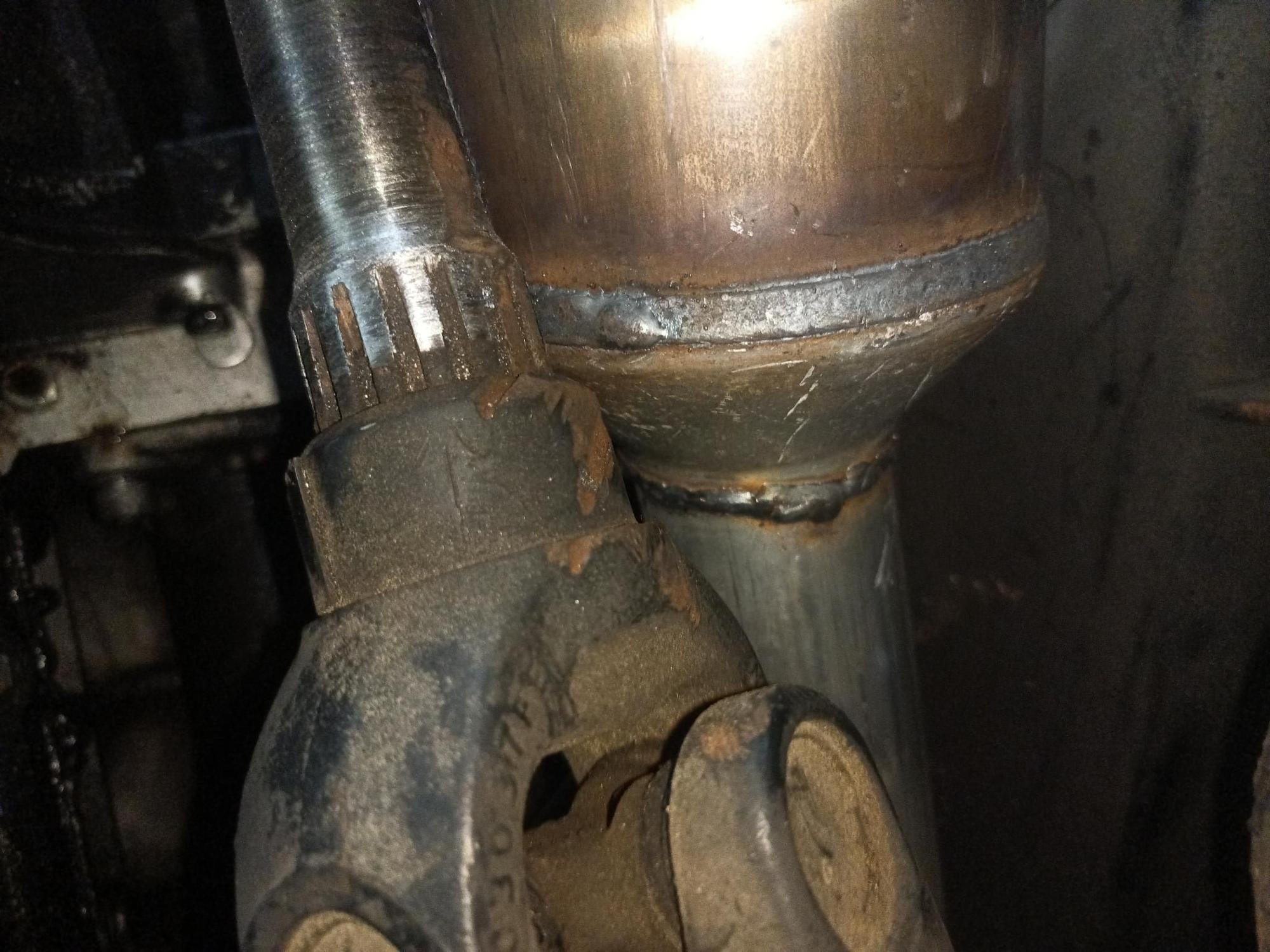

Hello, I'm trying to revive a US market 1994 Land Rover Discovery V8i that I purchased recently.
The cats had been stolen off it before I bought it, so I had to get a new Y-pipe.
The new y-pipe doesn't fit the best unfortunately, and the catalytic converter on the right hand side is interfering with the front drive shaft in a big way [pic attached].
Normally in a situation where exhaust hits something I'd just take a hammer to it and get clearance that way, but I don't think I should be hammering right on a catalytic converter.
What would ya'll suggest? Maybe I cut the pipe into multiple pieces and put a couple of flex adapters in to shift it over a little? Not really sure how to approach.
Thanks!
Picture of cat pushing hard into front drive shaft.

The cat on that side is usually not a round cat (like the drivers side) due to the clearance of the driveshaft. It should be more square and taller than it is wide. Where did you get the Y Pipe?

That would make sense that it's supposed to be taller than wide. I got it off rockauto.com.

Gotcha yep that cat is taller vs wide for sure! Never have bought cat's from Rock Auto, but I'd look into a refund as that won't work.

I guess I would cut out the cat and weld in a piece of pipe or flex. The heat from that cat can degrade the drive shaft, especially if it is really close.
My '94 came with the innards busted out of the cats, so less heat there. No downstream O2 sensors on the 94 so no codes with straight pipe or empty cats. Of course follow your local regulations.

Nope, not straight. Pipes taking place of cats have larger i.d., the front i.d. is just a little larger than o.d. of stock pipe and rear i.d. is a bit larger still. Allows for angles. 🙂
I'll get better pictures tomorrow.
Friend set up a fixture before cutting the cats off.
Welded in some sparkplug non-foulers for the downstream o2s. Takes the tips out of exhaust flow. No codes.
