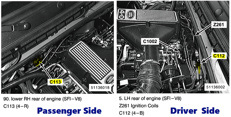

As mentioned the Pre-CAT O2 connectors are near the firewall (see pic).
If you can't find the female ends of the connectors ( C112 & C113 ), then look for the wires.

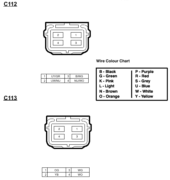

The connectors and wire color pin-outs are below.
