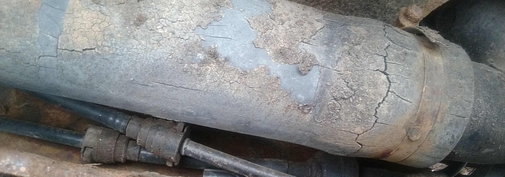

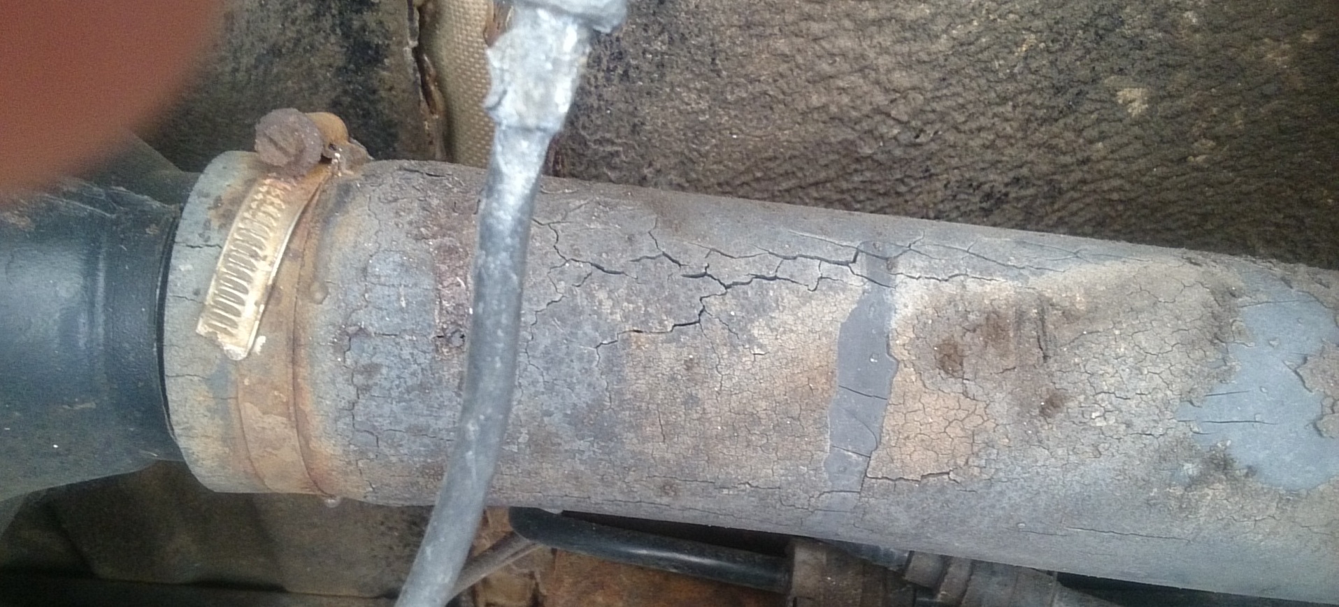

I took another good look under the hood this morning while engine was cold and still no leaking or gas puddle.
I did however look at the rear and sure enough aemnky606 was spot on as where to look. My filler tank hose has seen better days and needs to be replaced yesterday! Yikes! The vent hose needs replacing too. Though I never saw any gas puddles, these cracks must have been releasing some pressure along the way.
To anyone looking for the parts numbers here they are
Fuel Filler Neck To Tank Hose ESR2834 OEM
Fuel Tank Fill Vent Hose ESR1056 OEM
