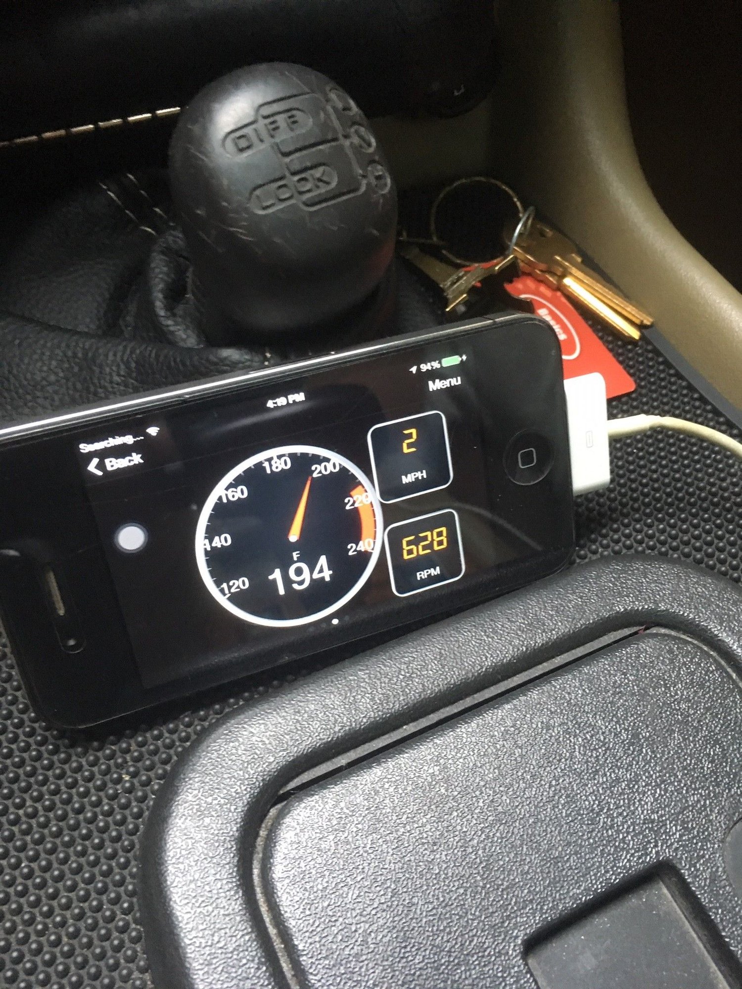

Check Engine light lit up this weekend so I plugged in the OBD dongle and fired up the app at the gas station to see what was what.
P0116 - hmmm... that's a new one to me. Search suggests a 'out of range' reading on the engine coolant temp. Could be a stuck thermostat or a sensor gone bad.
I cleared the code and monitored temps rolling down the highway. I KNOW this one is wrong.

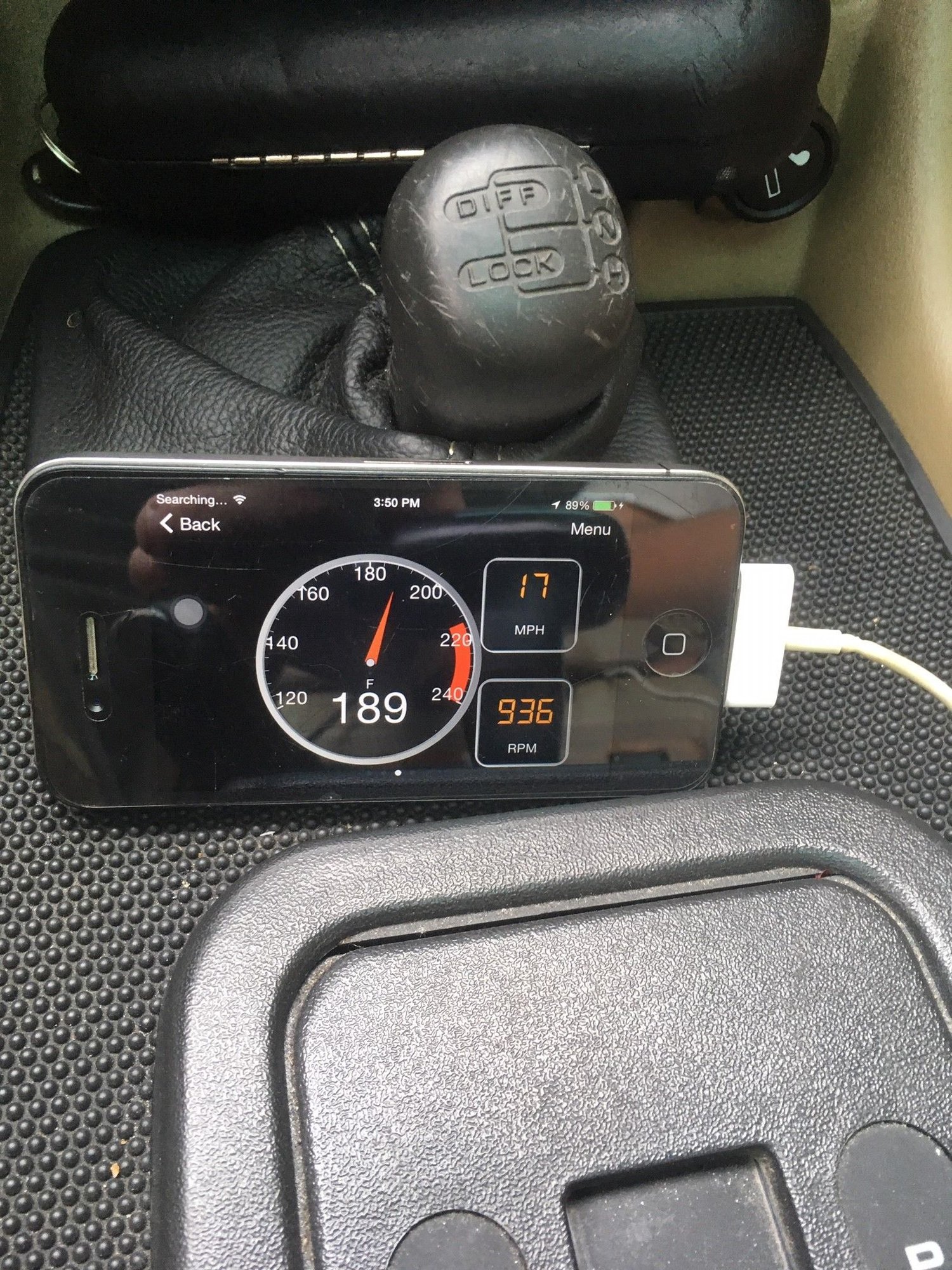

But this looks more like reality...

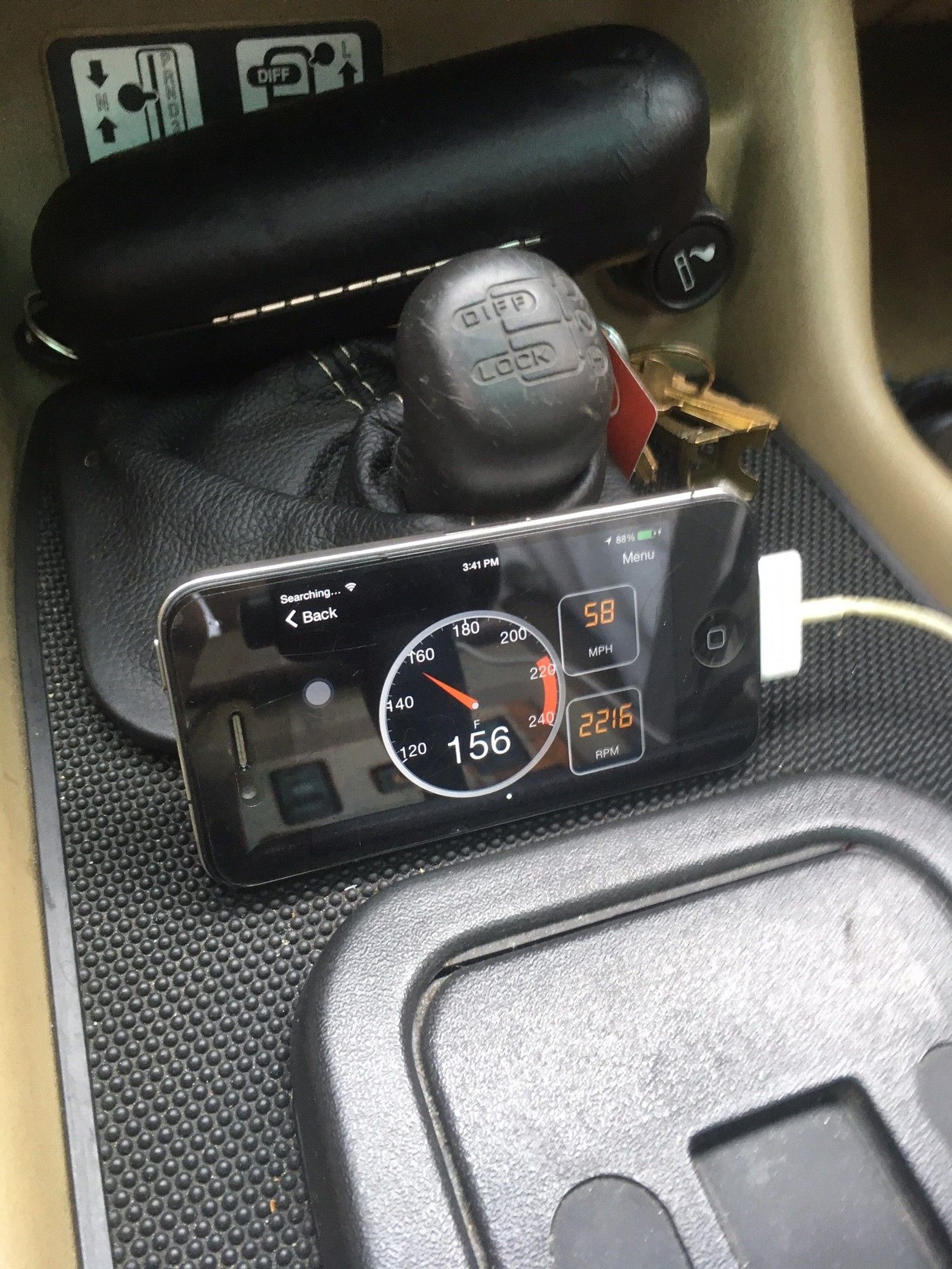

...and this one is probably accurate.

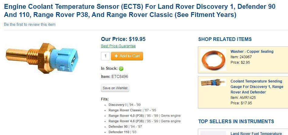

I ordered up a
Will report back on results but I'm optimistic this will be the correct fix.
