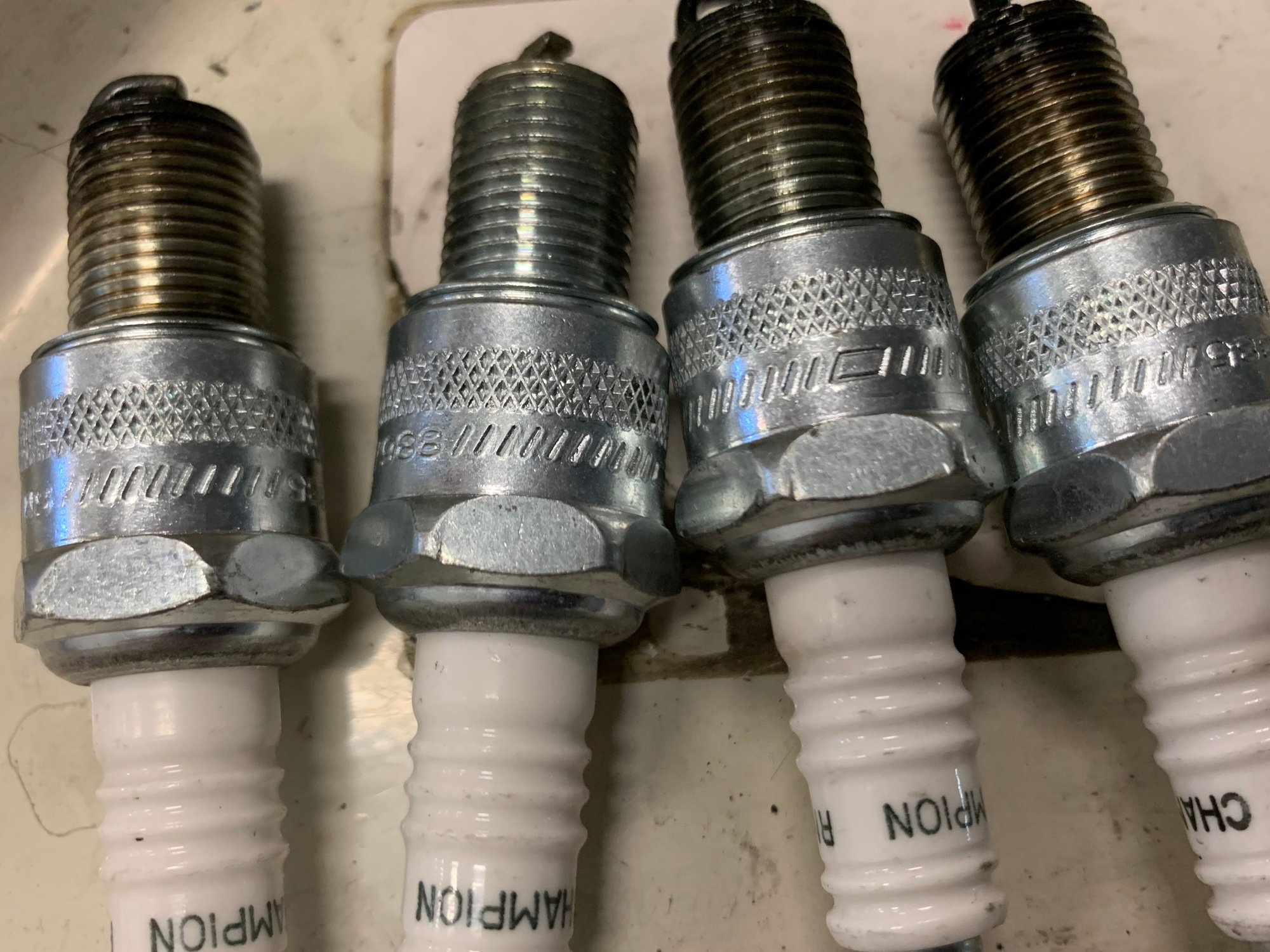

I pulled the new plugs on the drivers side and from left to right (1,3,5,7) you can see the variance in colour on cylinder 3.
I did have to replace a clogged fuel filter so bad fuel has been run through the system.
Is a clean plug #3 indicative of a problem with the corresponding injector ?
I have not changed the coil pack, but the plugs and wires are new.

Replaced the ECTS with a known good one and the P0116 is gone.
however, my P1316 misfire code is back and the engine still has a palpable miss at idle as well as running. I can’t test drive the car because I need to replace stuck calipers but in a short run there’s just no real power.
things I haven’t changed yet:
i haven’t replaced the new plug wire for number #3 cylinder with the old plug wire. (Remembering that cylinder 3 plug was clean)
I haven’t replaced the injector on #3
TPMS is observed to be changing properly (I’m using an ultra gauge to watch the values)
i haven’t syphoned the tank to remove the remnants of the old gas and the crud from the bottom of the tank
i haven’t checked fuel pressure. (But I don’t believe that fuel pressure explains the persistent miss and 1 miscoloured plug)
So I’m going to change the plug wire, in case I got a bad wire, if the problem persists, I’ll look at the plugs again.
after that I’m stumped.
sticky valve, bad injector ?

how’d gas get in the oil? Leaking injector Stuck open dumping fuel into the engine when It’s not time to fire?
I switched out the number 3 plug wire with the magnacore that was on the car when I bought it as a non runner. No change.
I’m thinking injector or stuck valve now. I’m going to hunt through your old threads now to see if I can learn something

Just to close this thread out, I pulled the intake and fuel rail back off to problem solve.
The intake had a warp in it on the passenger side. I didn’t have a spare one so I smeared a thin coating of rtv around where the coolant ports contact the valley pan gasket and reinstalled the intake. This time around I torqued the intake around the coolant ports first, then the exhaust ports.
lastly, I installed a set of gen 3 19lb Bosch injectors, reinstalled the rail and plenum and tested.
no more misfire!
I suspect that the #3 injector was bad , or at least clogged/ stuck open.
added bonus is no more coolant weep from the intake either.
