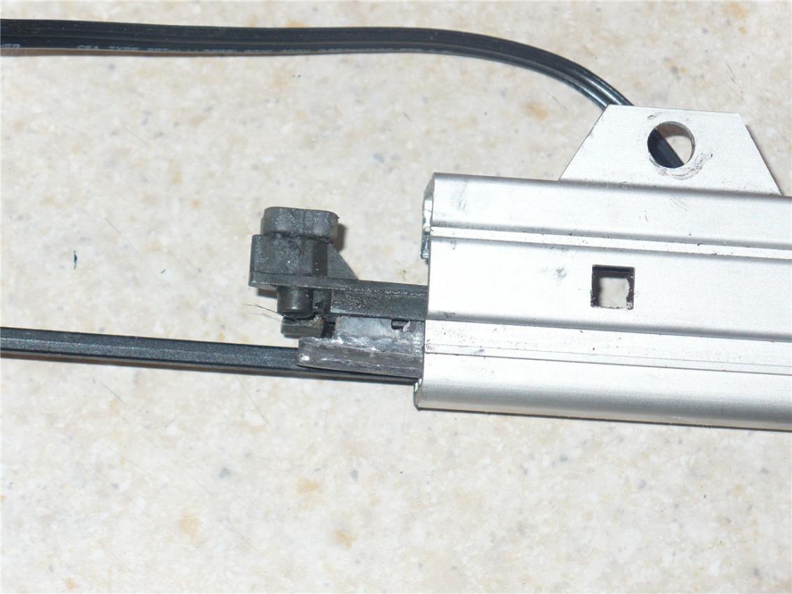

This picture shows the way that the fixed cable and the slider piece fit in to the sunroof rail.

So when should I send mine over to be rebuilt?

That is a really neat repair and I loved the pictures. Both of the sunroofs in the Disco I I bought for my granddaughter were bad when I got it. I have slowly been refurbishing it since last October and have reached the point of working on them. I need the metal pieces that the cable ends fit into as well as needing to repair the end pieces. I wonder if anyone knows where or if they can be purchased. If anyone does contact me at coinhunter at charter dot net.

really nice work there.

Thanx so much for the class & pdf. Both of my sunroofs are broken. The morors are working but nothing happens. They are both loose so a couple gallons of clear RTV are keeping the cab dry. I have a shed full of replacement parts and lift components that "one day" i'll have the time to get around to.
