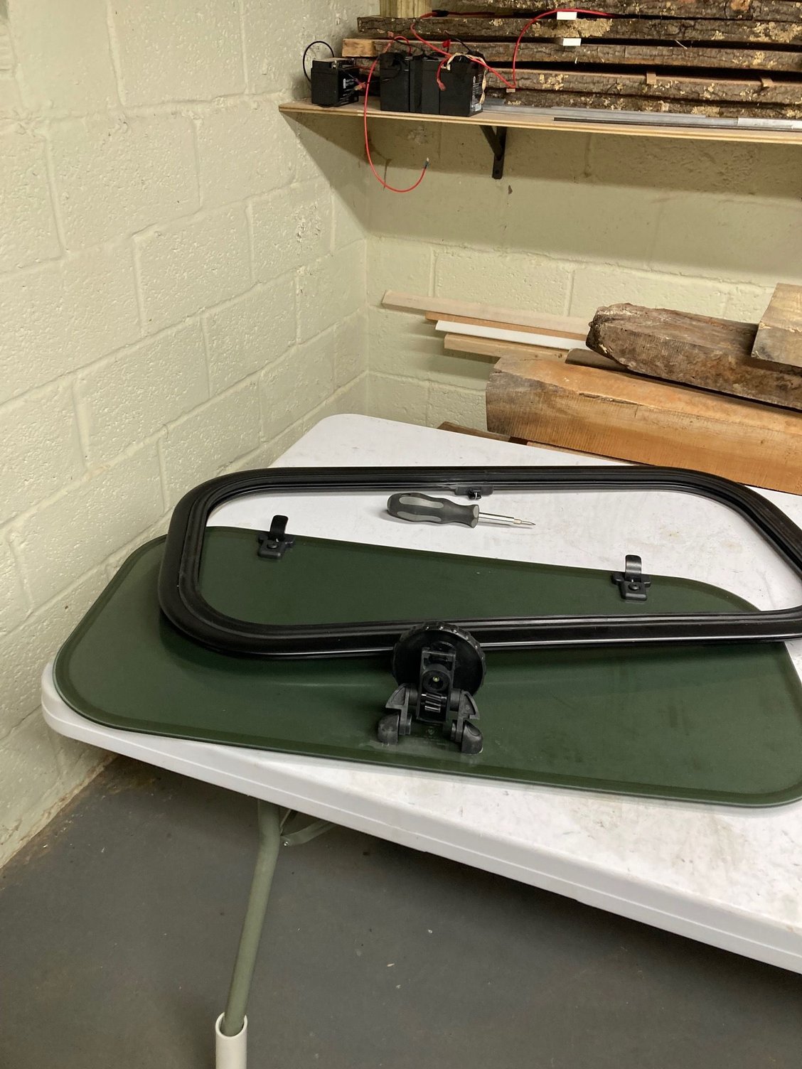

Contenders for a manual available in the US are: finding a used OUS manual crank sunroof from UK or other region, locating a new old stock Discovery 1 STC8096 manual sunroof unit, or possibly using a Defender manual assembly (which looks fairly similar to the STC8096).

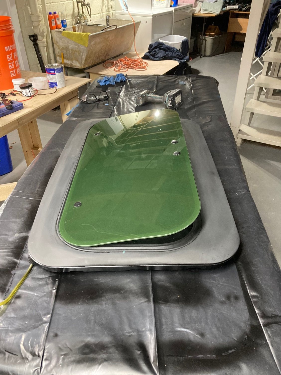

I found a STC8096 at a reasonable price and decided to try it. I quickly found that the dimensions of the manual sunroof are different from the power version, with the manual unit being a bit more narrow than the power unit. Therefore a frame was needed to fill the gap. I sourced a used upper and lower sunroof frame on eBay (basically just the plastic trim that surrounds the glass + the interior tray. Both of these sandwich together over the roof panel using ~10 bolts. Although after my research I was under the impression the Discovery 1 and Discovery 2 power sunroofs were the same size (with different drive components), this was not the case (more on that later).

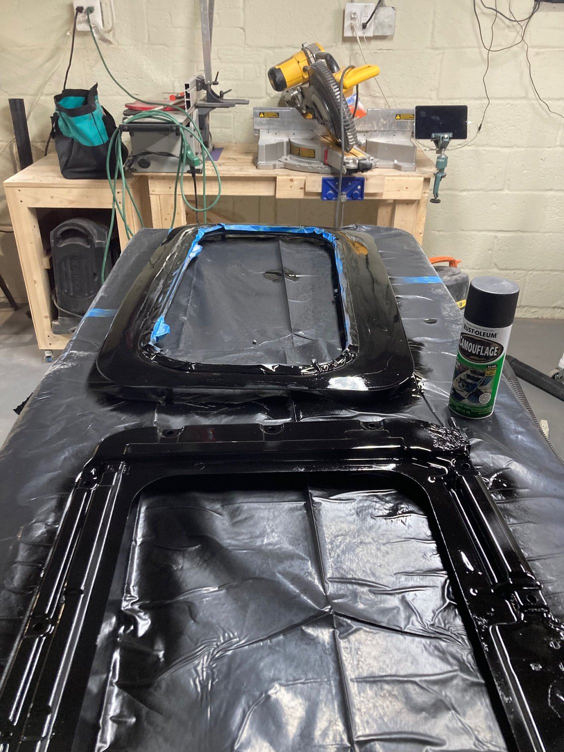

To bridge the manual sunroof and the frame assembly, I used epoxy putty. It took a number of applications to build up enough materials and then fairing to a decent shape. Probably someone with more patience could have done a better job, but I was happy with mine in the end. Coats of primer and matte sealant were applied to the final version.

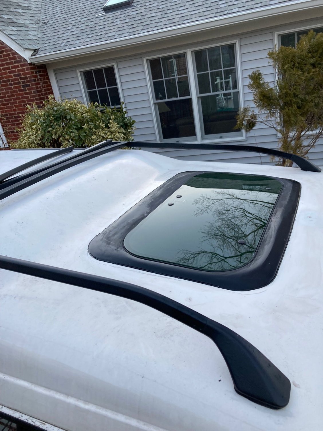

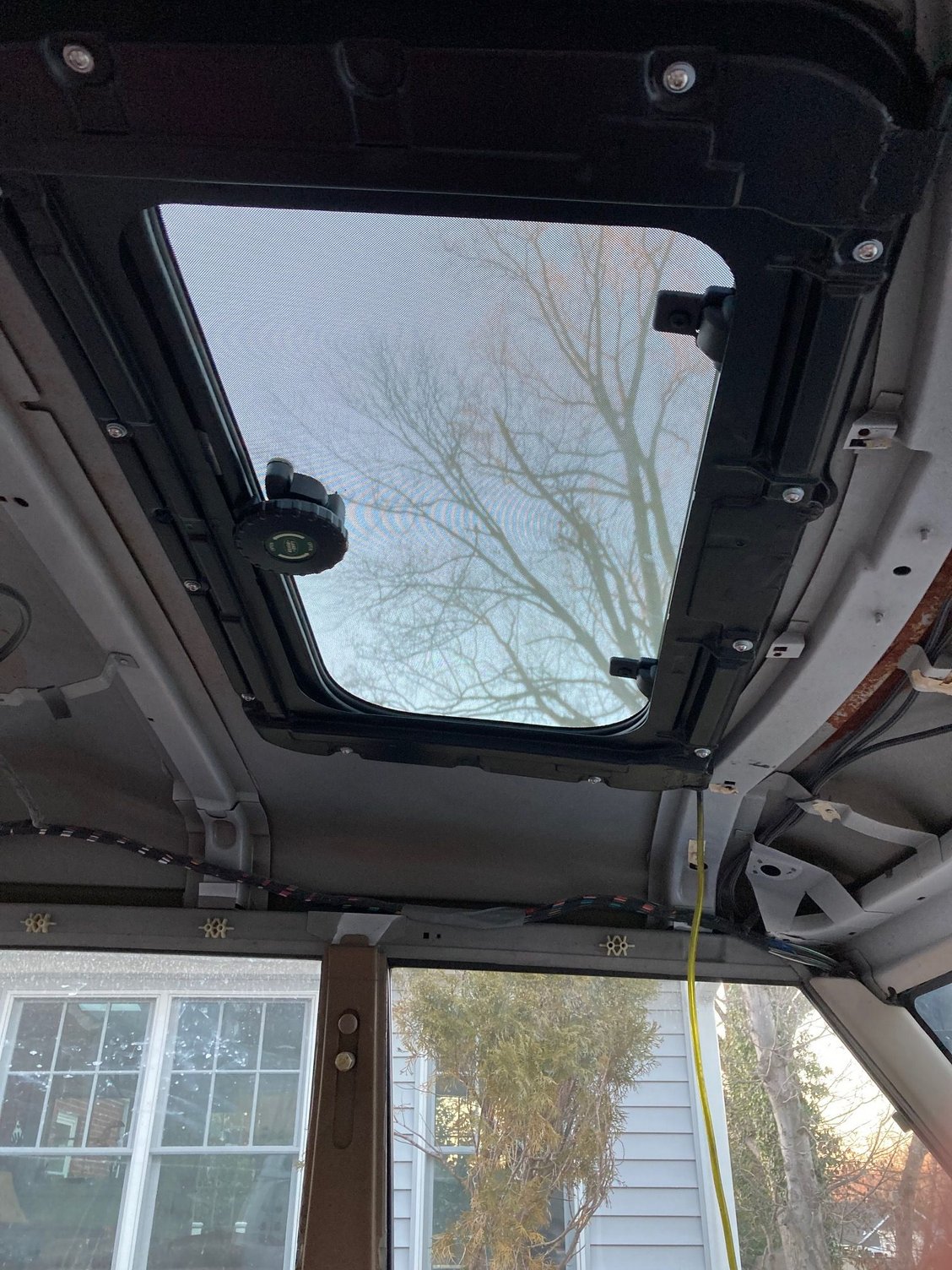

I removed the entire original sunroof. However, when I test fitted the new upper assembly, I found that it was a bit wider than the original hole for the power sunroof, which meant I had to trim ~1cm from the rearmost dimension of the hole. Not fun or really advisable, but I was too far into the job... After the trim the new assembly fit well and I sealed the inside and out with RTV sealant. My truck is a 1994. Not sure which year they switched over the to new "D2" dimensions.
So far no leaks with the replacement unit but I'm sure that will change over time. One advantage to using the upper frame and tray of the "D2" version is that the tray actually has drains for leaking water to run out of, unlike my original which had no drains I could locate
So in the end this was a much more involved job than I was planning. The only redeeming feature is that the STC8096 glass can come completely out of the frame which somehow is cool to me. It has a carrying case for storage in the car so it doesn't get scratched etc.
