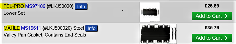

If you want a quality VPG then get a FEL-PRO or MAHLE/Victor Reinz. They fit spot on the first time and perform like they should long term.
I've used these (and the valve cover gaskets) many times with ZERO issues.
RockAuto has a decent price, but you can get these at any local NAPA, Advance, etc.
