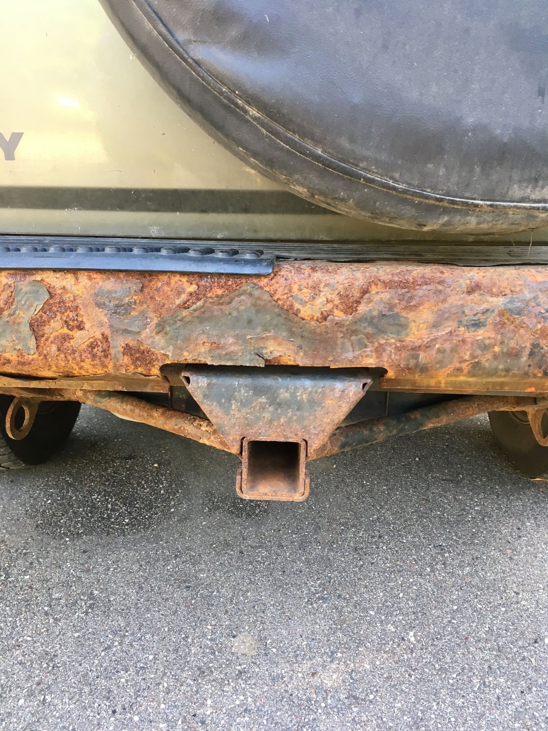

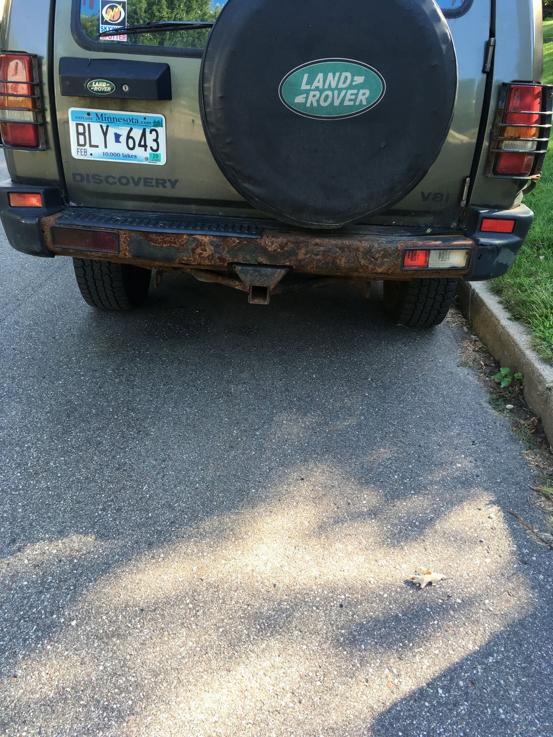

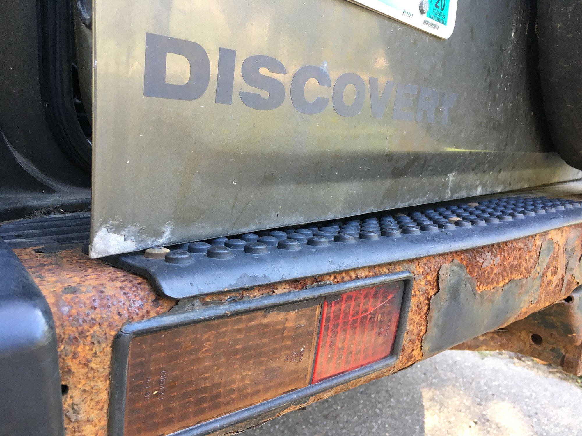

bend on pass side
gap above hitch
dragging at outside edge of door clears once it is past the bumper
maybe the wife needs to stop bumping into me when she parks.. door doesn't hit the pass side of the bumper where it is bent, tire hits the light first. Bumper is higher away from the body than the side closer to the body so tweak does make sense. Surprisingly with all the rust, lights still work good!

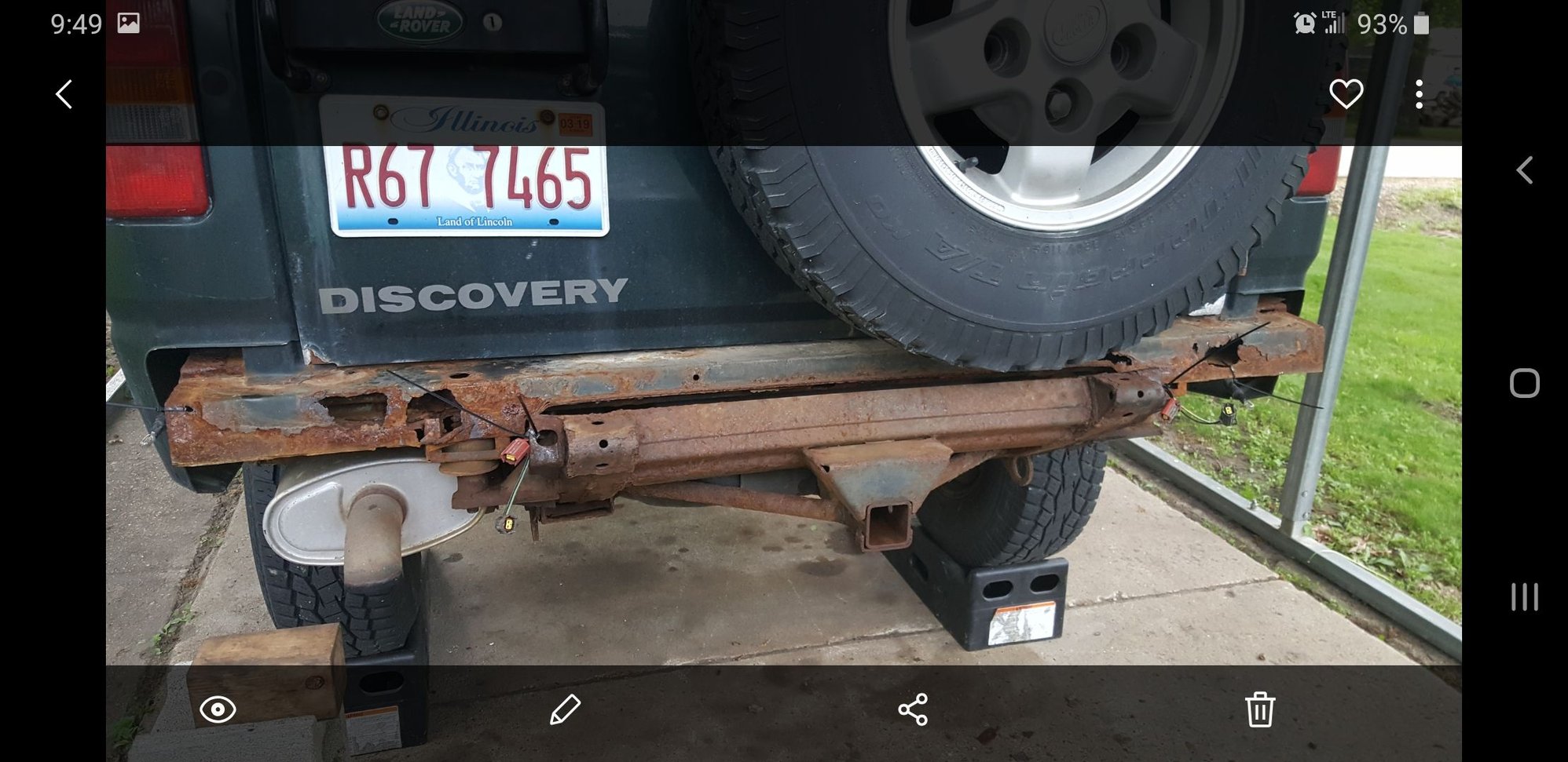

You're gonna want to check those body mounts. You shouldn't need to pull the bumper, but it helps. I'm betting you find something like this!
That's my truck. Body mounts were shot and there wasn't enough good metal around it to attempt a repair without major work. The bumper didn't move, but the body sagged. It sagged enough where it sat on the fuel lines and wore a hole in one.
