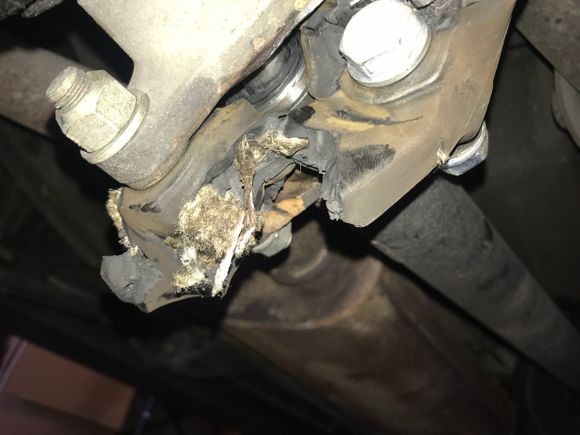

Proud owner of a 1996 Disco SE7. Longtime reader, first time poster. Noticed severe vibration from rear drive shaft. Went under the car and here is what I saw, rear drive disintegrating.
Wanted to pulse the group and and see if this is a whole drive shaft replacement or just the coupler going to the rear axle.
Also curious what caused the friction and wear. Thanks in advanced.

You just need to do rotoflex not a big deal. Fairly cheap and I'd stop driving until you fix it
Give the guys at Lucky8 a call they will fix you up with parts you need

awesome thanks. Will give them a call and provide an update.

thanks all for the help. I replaced the rotoflex. When I unbolted the driveshaft from the rotoflex, the bearing in the driveshaft looked cracked so I decided to replace that. That was a mistake as getting it out required me the chisel the side of the bearing so it collapsed on itself. I managed to get the driveshaft off the vehicle but couldn’t get it back on. I drove with the front drive shaft to a mechanic to pop the rear drive shaft back on and then I swapped out the rotoflex and the car is running great now

Sorry to hear you spent your money on another rotoflex joint.
They are a POS that will begin to vibrate and fail again.
You would of been money ahead if this a "keeper vehicle" and replaced the driveshaft with
one having a real steel U-joint with a four bolt pinion flange.
Waiting for a sale on these items and saving some coin is the best long term solution.
I replaced the original right after purchasing my D1 from the PO who hadn't a clue about a vibration problem.
Second then third rotoflex ( 3rd a freebie by dealership) failure I gave up installing a real U-joint, shaft, seal and pinion flange.
Mr. Rotoflex never liked the 4.6 engine with cam and chip plus 5 speed combination i'm running. So far at 70K miles later zero vibrations and no U-joint failures.
