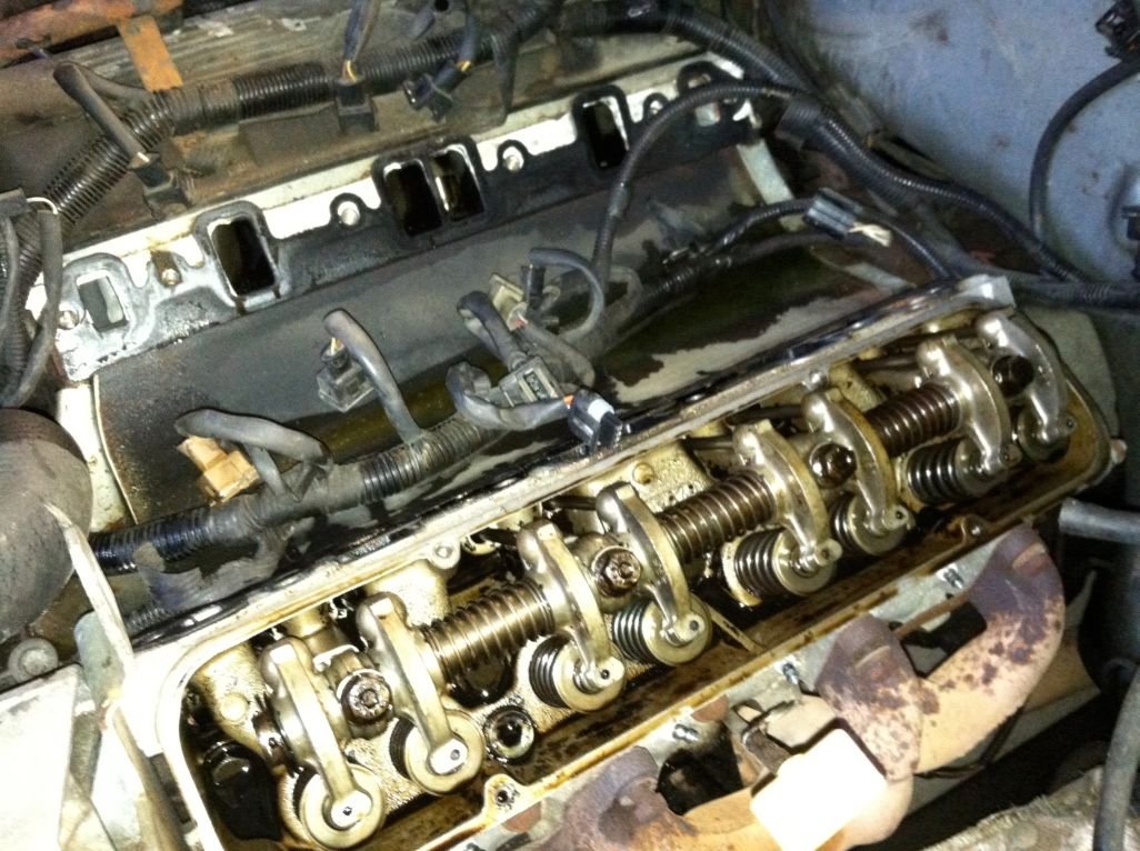

In order to do it right you have to disassemble the entire rocker assembly, then soak, then poke. The rockers and shaft are the two big culprits for low oil/no oil. There are two oil ports in each rocker and usually the one at the pushrod socket is carbonized and closed. I used stainless filler rod to clear em out because no amount of soaking removed the carbon cement. The tick is basically the rocker slapping the pushrod. I'd give it another go and I know you only removed the passenger side, the easy side. It's the driver's side that never gets any attention.
This pic was taken 30k after first head gasket replacement. Unfortunately I had to replace the first set since they sucked.

thank you so much for the pic, yes i did remove the passenger side how'd you know lol, i was going for the easier one haha. I didn't really didn't submerge the rocker assembly in solvent but i did poke a tiny screw driver in all the push rod sockets. In most of them there was blockage but now they are clean. As far as the left side i think that's going to be part 2 for next weekend. I think the tick is either the lifters gone bad of the dreaded piston sleeve lol. dont know if next weekend i should pull entire intake manifold like you did or just clean the rocker assembly.
