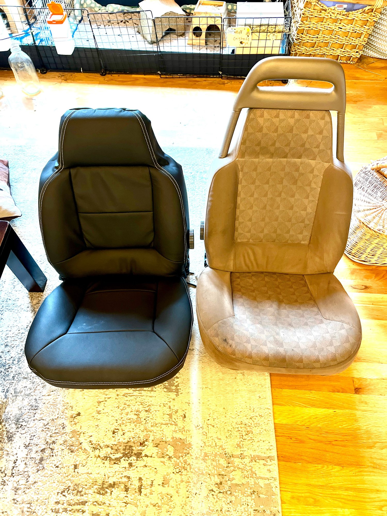

I just did a full set of all leather lseat. The fit isn't perfect and with the older Discos they dont' have the right clip for the rear seat leather and the shoulders of the seats are a bit loose. I did the full leather option and I think it was 1000 for all the seats.
I wouldn't buy from them again and probably would spend the extra 2 grand and have a real upholstery shop do it.

grew's Avatar
Joined: Sep 2022
Posts: 28
technically they are integrated. I put up a picture on my previous post of a completed seat without the headrest as I hadn't painted it yet.

Old Nov 15, 2023 | 08:43 PM
binvanna's Avatar
Joined: Oct 2012
Posts: 676
Likes: 43
Thanks. I saw the picture and thought I had missed it previously. Yours are the style seat more popular for older Discoveries and outside the US. I looked at Melville & Moon and they make covers for those seats but not for the ones I have that have separate headrests. Your seats look good, but maybe I can see some of the loose shoulders you described.
