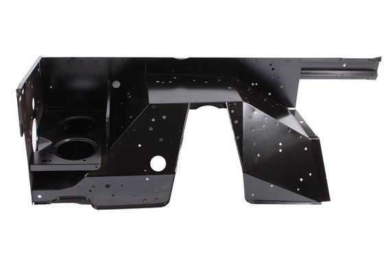

Sorry to hear about the accident. The part # you need is ALR9842. Rovers North lists the other side(ALR9841) so you might want to call them. But unless you can find a use one (keep looking!!!) it's going to be expensive to get it across The Pond > https://www.rimmerbros.co.uk/Item--i-ALR9842 Good Luck!

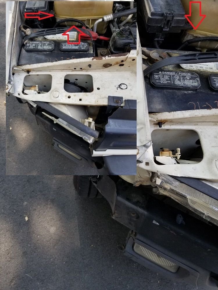

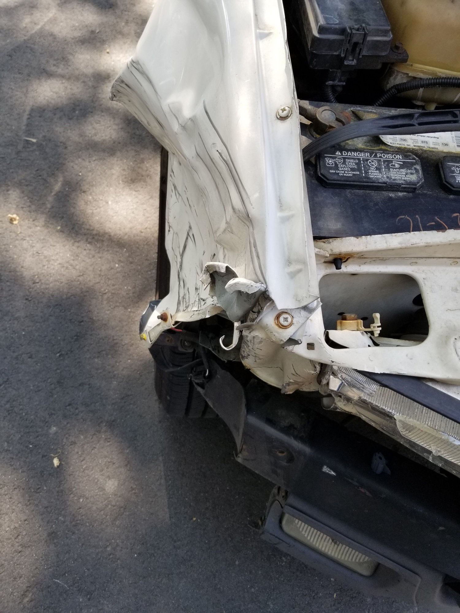

Thanks for the help guys. I popped the hood to take a second look and take more pics. I'm a newbie when it comes to discos. The steering is fine and the car runs as if nothing happened. Looking at the inner wing for the most part is pretty good just the front where the new headlight would go is pushed in. Hopefully it can just be fixed and not need to replace the whole piece.

Id repair the inner wing not replace. Nothing a clamp, come-along, dolly and hammer cant fix.

Not to add to your parts shopping list or pain, but remember to order a new coolant expansion tank (PCF101590) and tank cap ( NTC7161 ). The tank seam looks like it's leaking.
And whiskey is right have a go at fixing it. I've repaired metal is worse shape and face it you can't F it up more. I would only add one thing to his list ( Nothing a clamp, come-along, dolly and hammer cant fix.)........ TEQUILA!!!
Radiator bleed screw also looks like it's leaking.

If you are going to mess with the radiator fill plug, have a brass replacement with a copper crush ring ready to replace it. Those plastic plugs are prone to disintegrating and falling into the radiator when you try to take them out. BE VERY CAREFUL/GENTLE.
