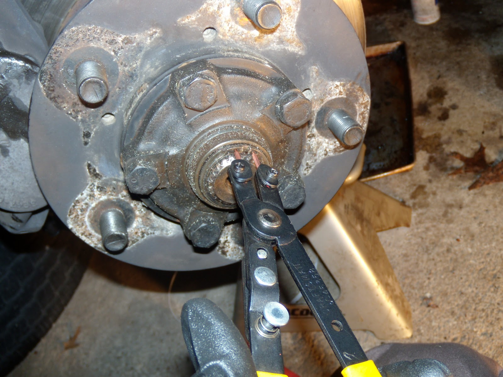

Overall the process was pretty straight forward once I had the proper tools. (proper tools are handy...) Anyone have any great ideas on how to get on and off that outer cir-clip thing? For something so small that was almost the hardest part I would say.

As far as the circlip, They make a special set of pliers called CirClip Pliers any major car parts place has them.
