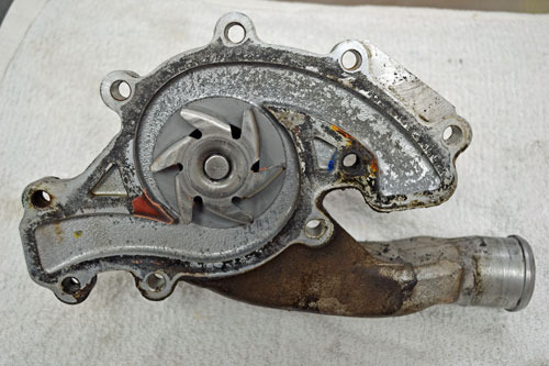

I thought the water pump was worn, as it was the only thing not replaced. I just pulled it out with 105k miles on it and here's what it looks like:
Not what I was expecting! I thought the impeller would be worn to nubbins, but it's not.
