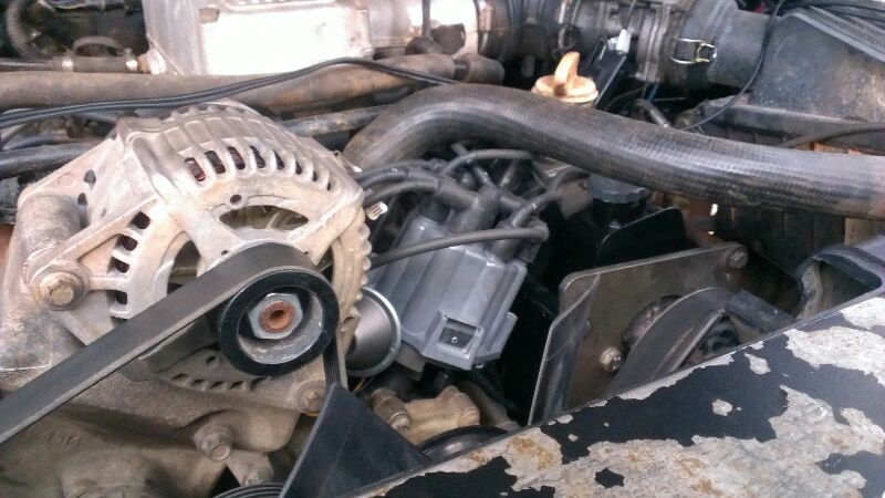

My setup moved the pump out a pretty good bit. Stock length won't even be close.
In the mock up stages on the parts truck before boxing it all in.

What fans are on the parts truck in that pic ?

oh wow, that is certainly a different approach than I've seen
Have you considered using a 93 dodge dakota pulley instead of whatever you've got? It has a 7 rib pulley and a later d2 belt may fit
Not sure if you've seen what I've got, but I put the drawings out there for a bracket and adapter to keep the stock length belt and hoses.
http://www.flemcodesign.com/saginawbracket.zip
had it on for about a year and a half with no regrets. Kind of gives it that buick engine look with my current distributor and also allows room to move the airbox over if you have a snorkel and dual batteries.
I'd also be concerned about belt squeel while turning with the AC on. you are losing quite a few degrees of belt engagement to the crank pulley and 1/7th the surface area

Yeah, I think I have your plates drawing saved. I just used a jeep adapter plate from PSC and modified it. It was super simple and Lane on pirate (mightymg) ran it on the red truggy and d90 on spider 9s with no issues. Only changes I made were boxing it in for more rigidity. Makes routing the lines super easy where it's at too. We will see how it works this weekend. I'm going to be running hoops for 14" coilovers in a few weeks so I'm going to be pushed for space. Hope it doesn't get in my way. Planning on a dry element cone filter off the maf run over the hoop to where the abs modulator is now sitting.
Tom, no clue what they are but they are in one of my box o Rover crap that needs to go!
