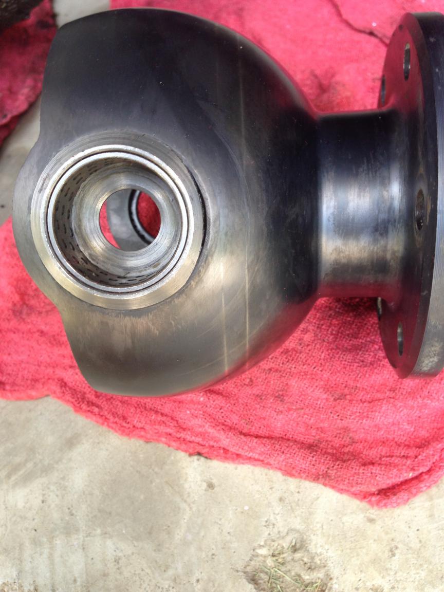

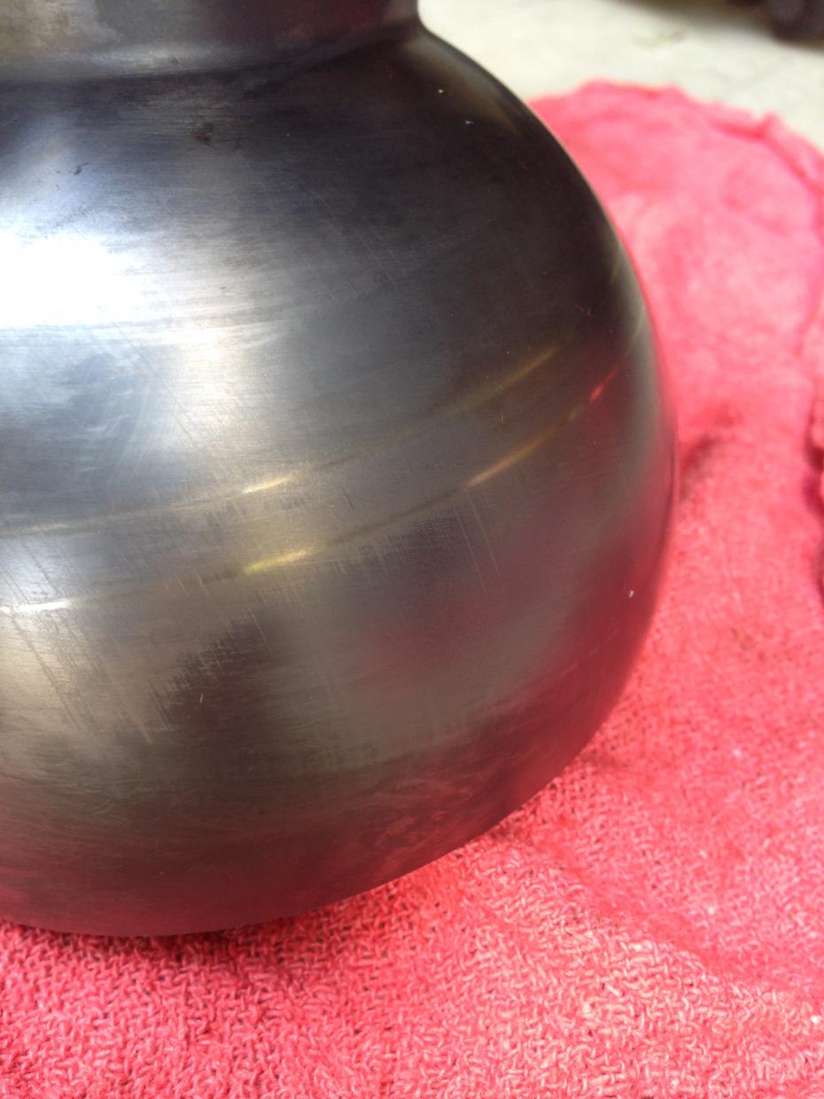

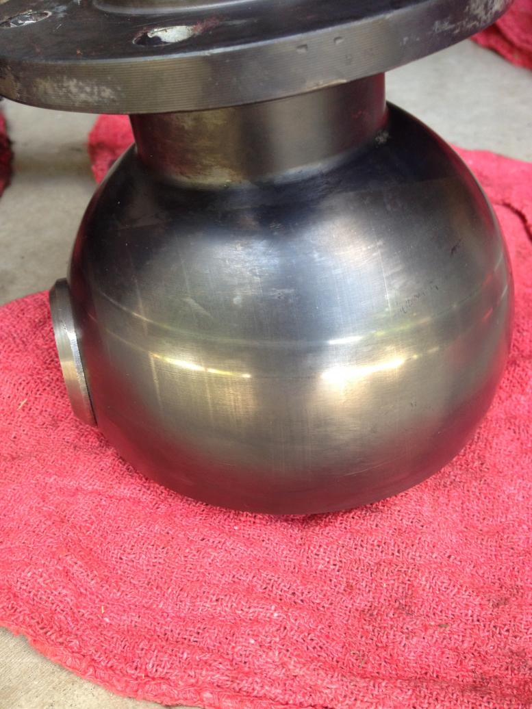

I was it the process of performing the defender brake upgrade on my disco1 when I was blessed I puddle of oil and grease under the wheel. So what started out as brakes and rotors is now a full swivel rebuild.
Here's my question......
Is the swivel ball in good enough shape to reuse ??????
My thought is yes, but since this is the first time I will be doing this rebuild I wanted input from all of you folks who have done this before to see what you think.
The lines on the swivel appear to be from the seal. Not sure why since there is no rotation. There are no groves and no pitting.
Yes. Compared to others I've seen, they almost look new.

Look good to me, my drivers was pitted bad
