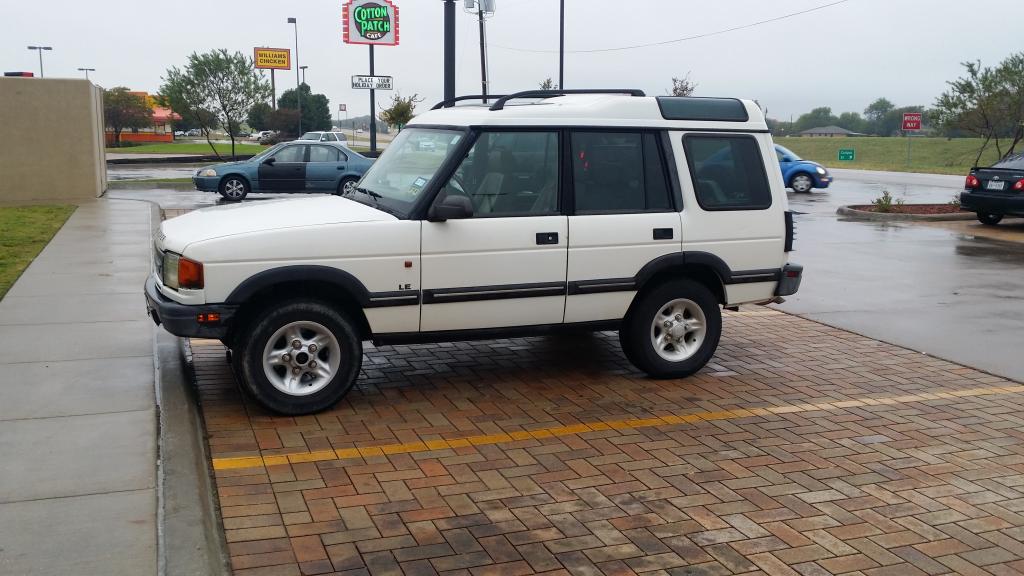

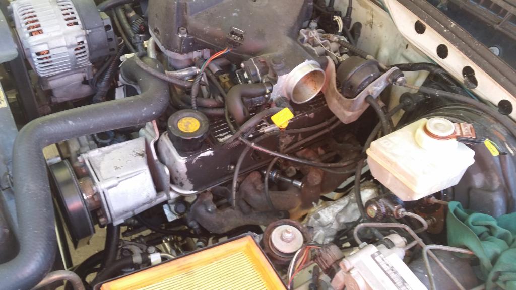

hello all! This is my 3rd Land Rover Discover I. By far the worst condition. It is a 1998 50th anniversary. it has 230k miles. i could not drive it home due to multiple issues. I was told that the head gaskets were done in the past. not sure when.
Radiator needs to be repaired. leaking driver side
bad break booster (heard vacuum leak inside booster and no power breaks)
Grinding noise on driver front rotor
AC not blowing cold Fixed! bad switches
valve covers leaking
valve train noise on driver side
leak on top of the timing chain cover maybe?
lots of cosmetic issues and a little bit of rust bubbling here and there
the ultimate goal is to get this vehicle running reliably for my wife to drive to work and back. She has a 2009 civic, but wants an 4x4 suv.

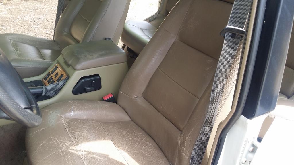

Haha you can see the previous owner tested his interior color changing skills. (looking for replacement)

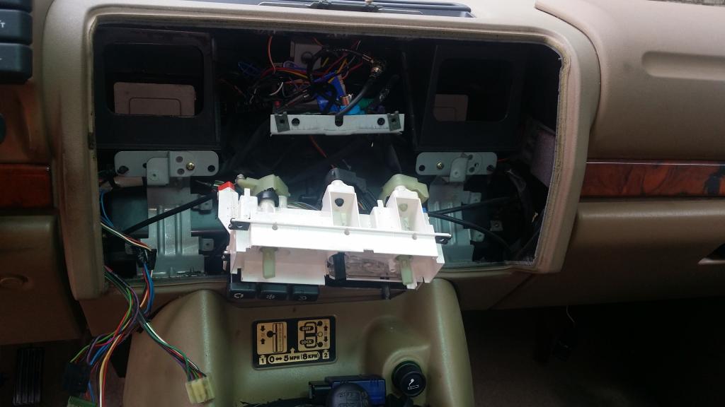

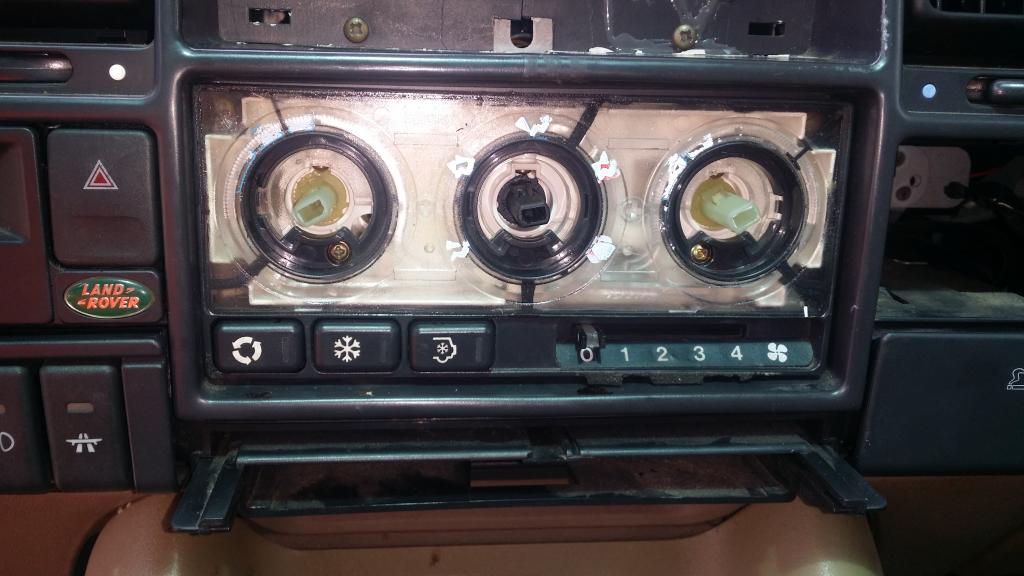

I fixed all my ac switches today. My snowflake , recirculation, and rear ac buttons were all not working.
The large trim piece I'm the center of the dash cracked in multiple places do I am waiting for the JB weld repairs to harden overnight. Will put all together tomorrow and have some cold air!

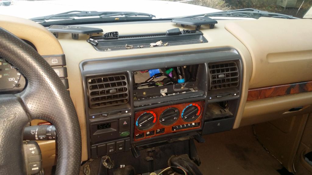

fixed up the trim piece and re installed.
i really need a new ac control face plate. the sticky stuff is messed up and the wood part is junk

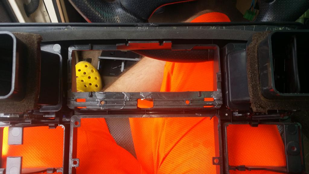

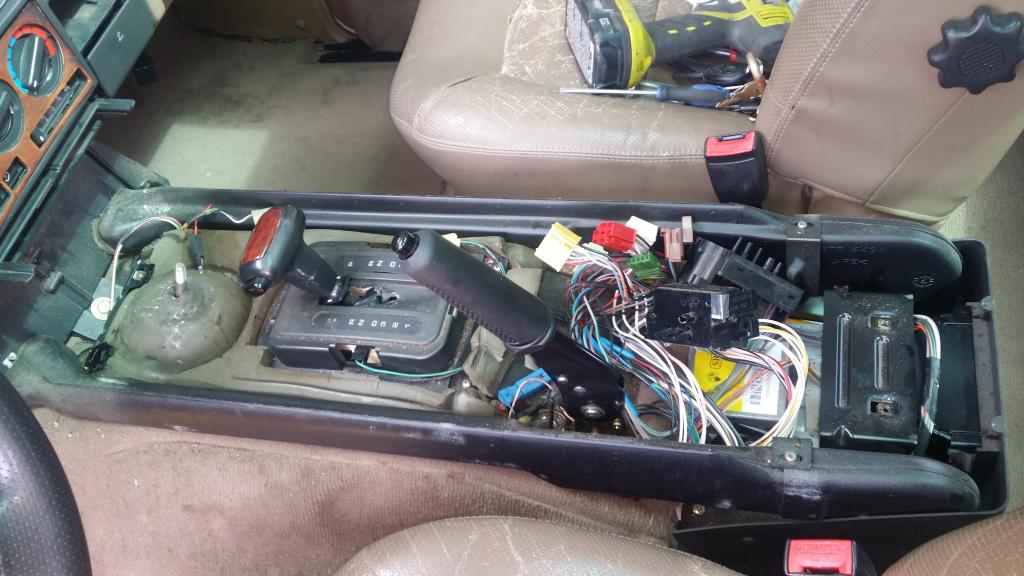

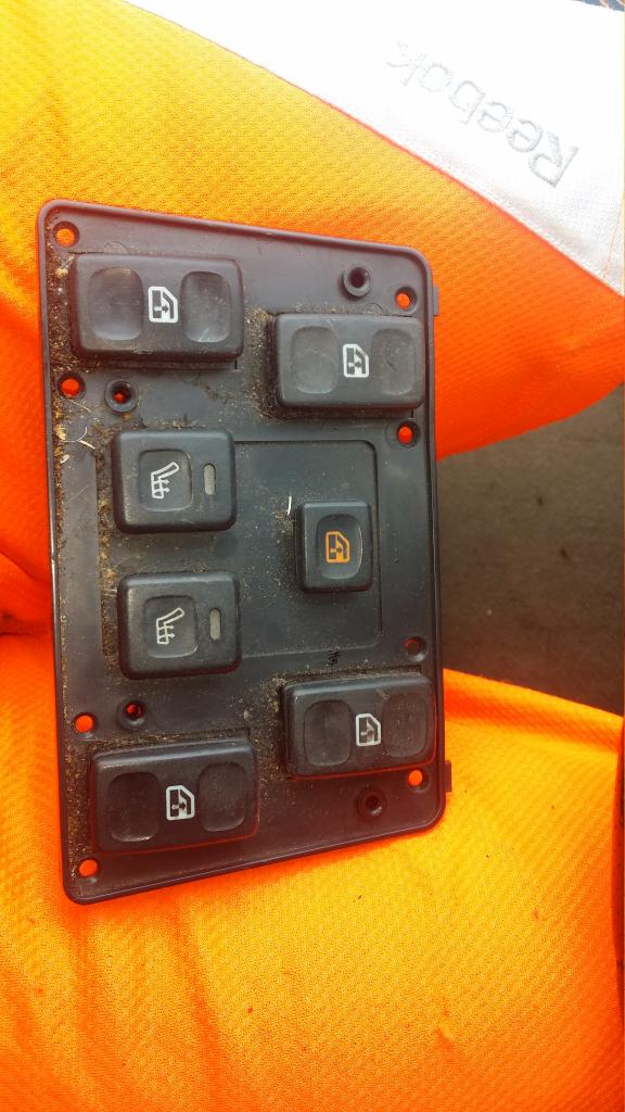

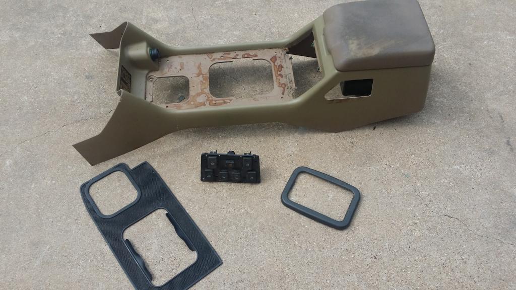

removed the center console because it, and all the surrounding area was nasty. I also repaired a few switches
got the pieces clean. but not gonna install till i find a shifter trim piece

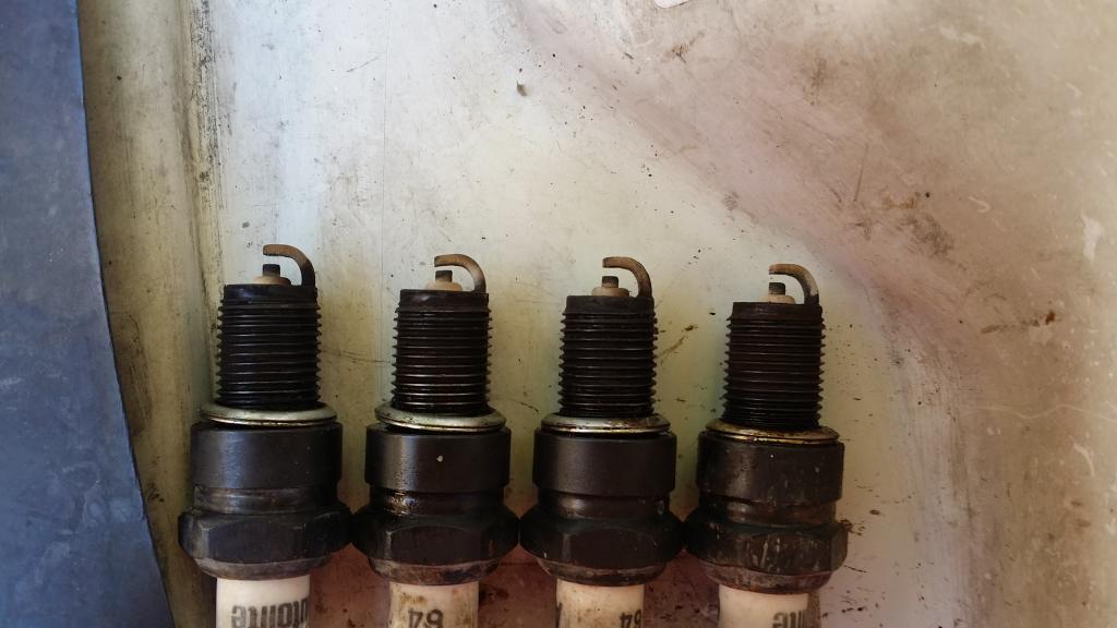

Things I did on the rover today
Changed front and rear diff oil
Transfer case oil
Greased prop shafts and joints

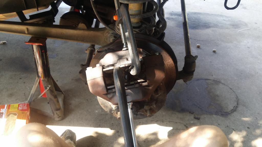

Front Brake pads
Engine oil and filter
Spark plugs with champion 322

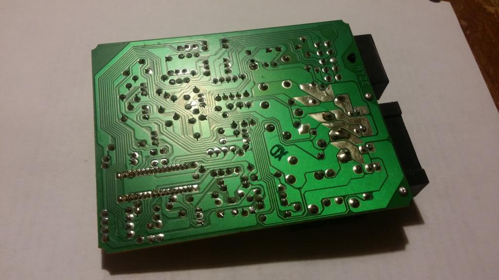

Repaired window Control ECU
Some pics

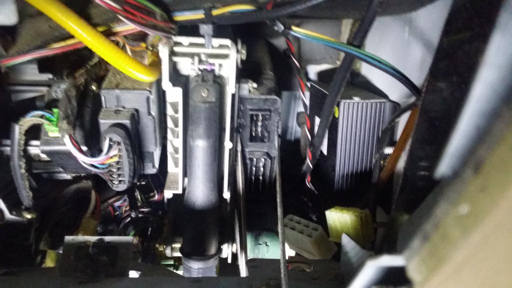

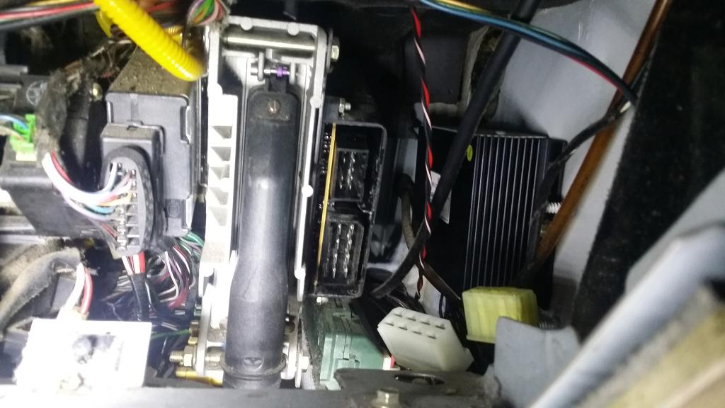

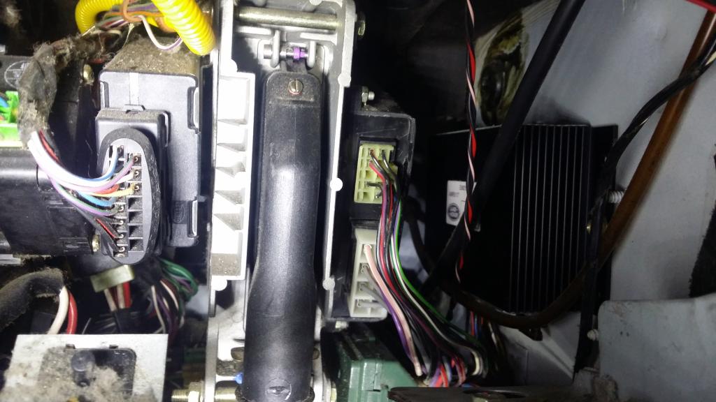

Removing and repairing window ECU
behind glove box

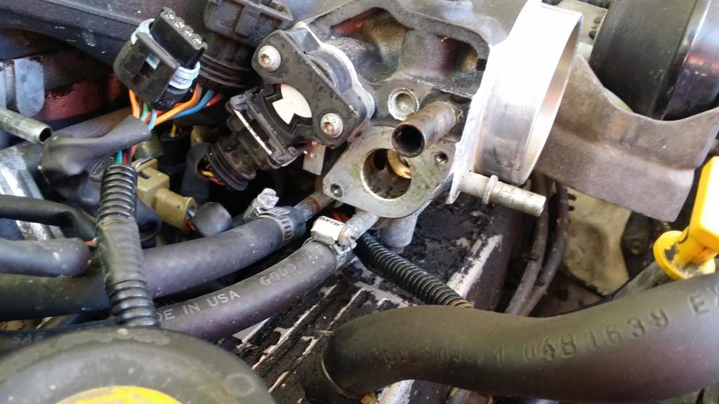

Went to clean my IAC and noticed that there was a paper gasket. Isn't there supposed to be an O-ring? I cleaned it and re-installed. I so had to replace a screw that was missing
Also, has anyone bypassed the throttle body coolant lines? I've done it lots of times on other vehicles. I live in nice warm Texas.
