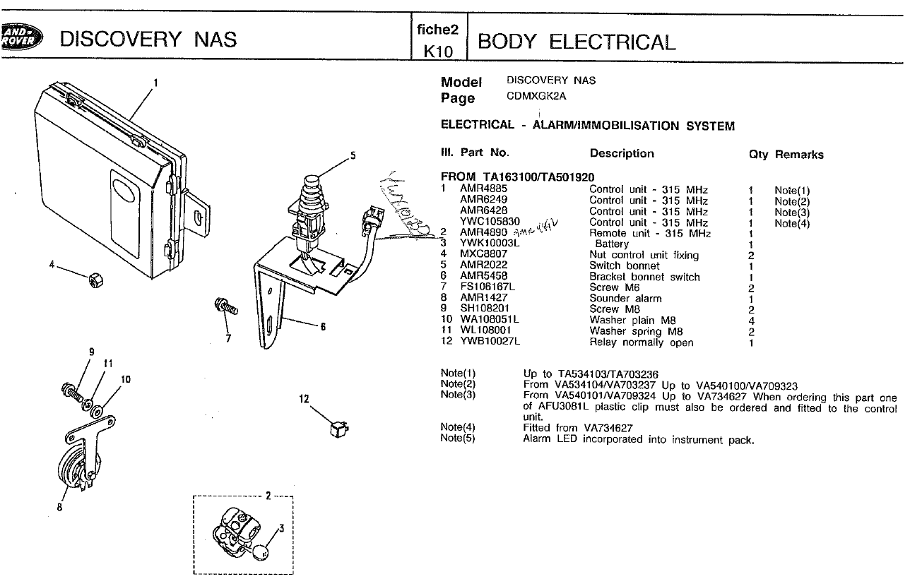

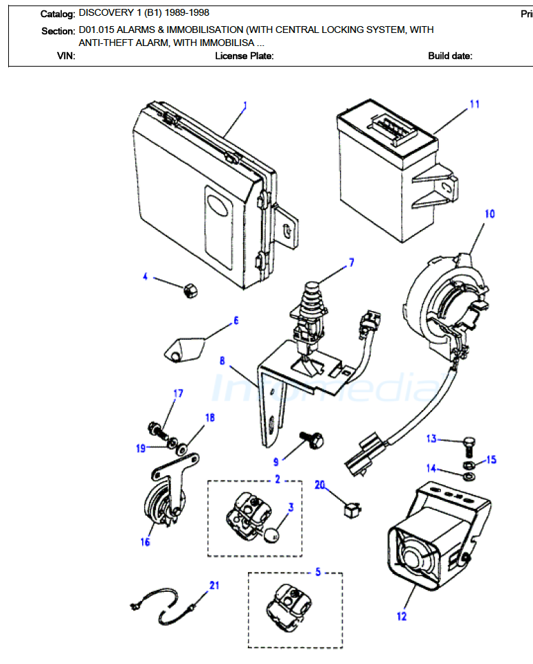

Just adding this for reference.

There....I fixed it and added a photo...
HARNESS 300 TDI KIT RANGE ROVER/DISCOVER, AMR4956 - Rovers North - Classic Land Rover Parts
