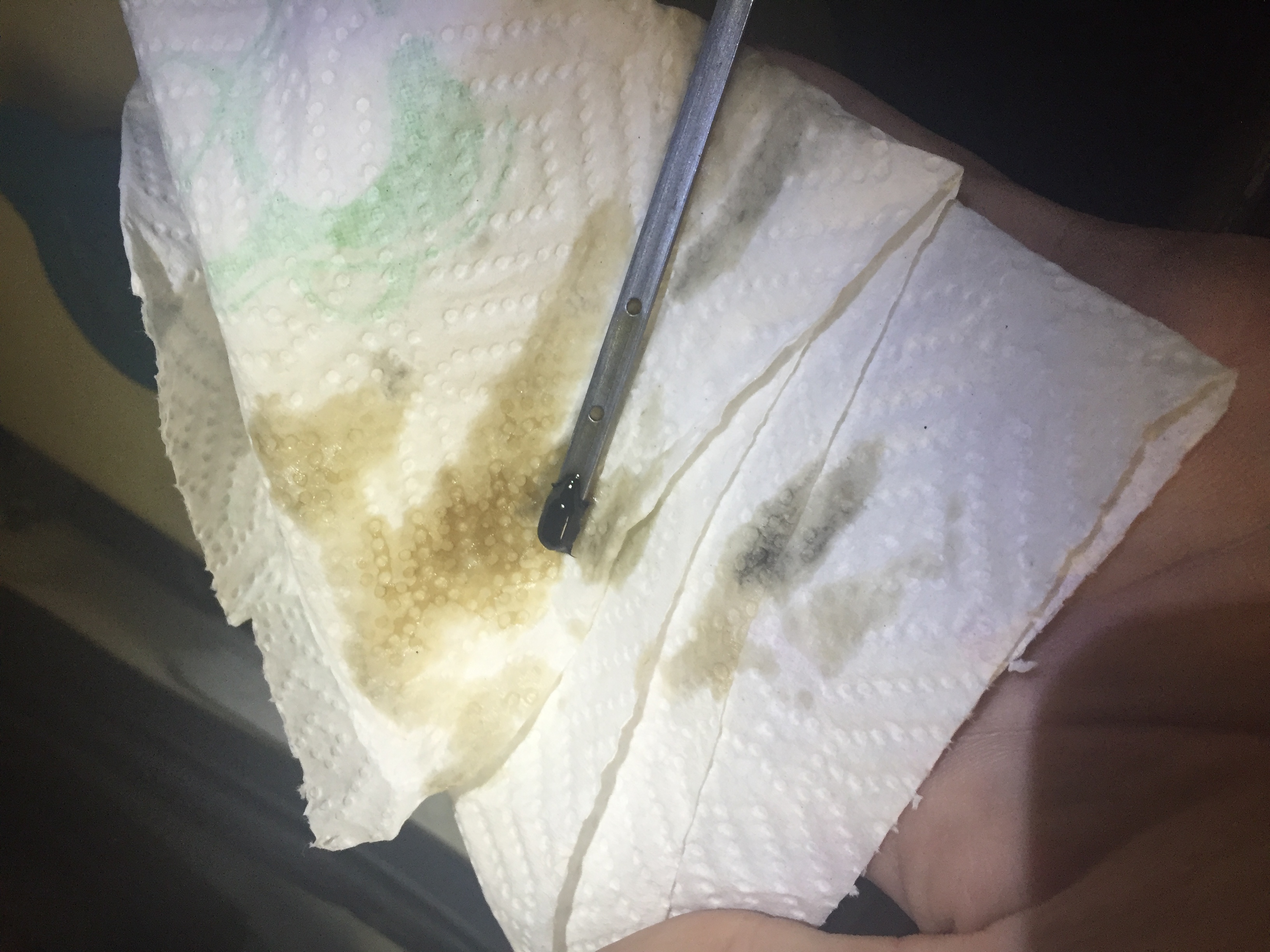

I had a question regarding my transmission fluid. Let me preface first by saying I'm not having any transmission issues. My disco shifts up and down smoothly. It does clunk usually when I put it into reverse, but I've read that isn't something to be alarmed at.
I checked my fluid and it doesn't seem to be red at all. Honestly it looks like standard motor oil. It doesn't smell burnt to me, but I'm unexperienced in this area so I don't really have a benchmark. I've included a picture here for reference.

Um, I'll take a guess and say "Transmission Fluid"?
Is that a diaper? Good idea if it is.
By the way, copper/brass radiators use lead solder and not the hardware store stuff.
Dextron III is what's recommended. Drain off what comes out of the radiator tank, fill to level. Drive for about a week or two. Then leave the current filter installed but REPLACE all the trans fluid. In about 5k change the filter (which you will deeply enjoy) and replace the fluid once more. This should prevent dislodged old solidified fluid from ruining a nice day.

I notice you have really low miles and the color of the fluid tells me it's probably original. The red dye has disappeared and with that you can imagine the striation that occurred if it sat for a long period without being disturbed. To be absolutely honest I wouldn't have started the engine with fluid that color. The "Service Sheet" on a 99 D1 says the first filter change is scheduled at 30000 mile mark or after 24 months. I wonder if yours was ever changed and inso wondering I would err on the side of good judgement and just replace it, no worries. Same goes for the fluid, replace it. I just don't like to introduce both all at once because transmissions are not easily rebuilt (or understood) for the average weekend DIY'r. We don't just meet our future spouses and get married after the first date, takes time to get to know one another and that courtship usually lasts over a year. Same applies with new fluid, new filter, simply trying to reduce the possibility of failure. I doubt anyone has rebuilt a transmission and especially our resident ID10T. I have.

As far as I know, the vehicle never sat for an extended period of time. It was just used very sparingly on a weekly basis. But that definitly makes me nervous what you said. Like I said, I haven't had issues with the transmmission yet and I've put around 2k on it since I bought it. If you think its best to go ahead and replace the filter and fluid though that'll be my next project.

Yeah I've looked into the filter change and just don't know if I'm "there yet". Since it is performing as intending I think I will go ahead and just change out the fluid so it'll be nice and red.
