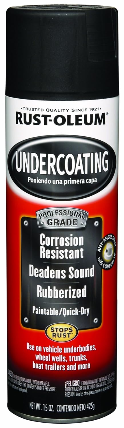

I use the pro grade rubberize undercoat and love it. accidentally, used the non professional grade and it sucked, worthless..... moisture trapping, slow drying, crap.
the professional grade is the only way to go with the rubberized. its extremely durable, sound deadening, non trapping, but I spray a top coat over it.

Is there a certain brand in the professional stuff that you like? I like 3M everything, but if there is another brand that is better than I would rather use that.

I've use both rusto and 3m. I like them both.
I feel the rusto is better coverage per amount and the 1gallon sizes are easier to get.
so, the rusto is what I use.
