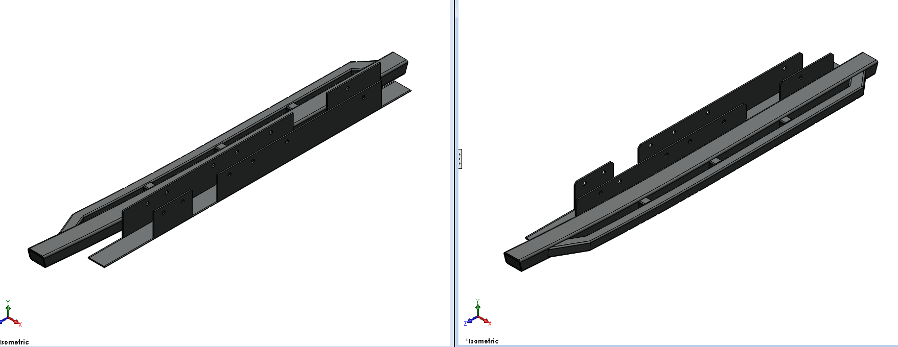

Started creating cads for the sliders with built in side steps, based on the pdfs floating around this forum. Bringing the D1 to the office tomorrow and making sure all of the dimensions line up.
