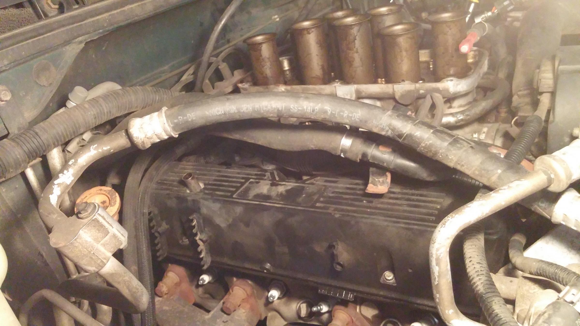

So far, I've remove the cover on driver side, decided to take the plenum apart as it looks really crowded, see attached picture. Everything seem to be in place solid with no movement or anything looking worn. I have a few questions to ask before I move on to taking it apart.
1. Reviewing Rave, seems straight forward but to confirm, I remove the 4 bolts on top, mark the rods to ensure proper sequence.
2. Before I do anything else, should I place the plenum back and run the engine to see if I can locate the noise? Everything seems okay on observation so tempted to just take out the rocker and giving it a good clean.
3. The driver side cover seems lodged underneath the rules lines on the inside an coolant hoses on top, I managed to get enough room to unscrew but have temp put them back. See attached picture but wanted to get input if that's the only way to get enough room to remove the covers.
4. The rubber gasket for the cover, is that reusable or should I get a new one.
Attached Thumbnails Valve Noise Help-rocker-cover-pass.jpg   Valve Noise Help-rocker.jpg
